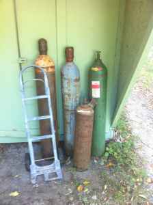

Oxygen Tanks
Will welding gas suppliers fill rusty oxygen tanks? Pic of tanks in question attached.
@crazyboy: metabisulfite will work fine. About the inert gas, CO2 really limits the reactions that you can use the inert gas for. It seems you have overcome the hurdle of obtaining a regulator and tank, can you not find a place that will fill with N2? As i recall both use the same regulator.
[Edited on 10-4-2010 by smuv]
in my experience they will fill a tank as long as it is certified and within the certification date barring any obvious physical damage.
Agreed. I want to add that there do exist companies that will do hydrostatic tests on privately-owned cylinders. Mostly this is done in-house by the big gas suppliers (e.g. Praxair), but they don't have a completely exclusive lock on that service.
