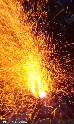

Here's some photos. There's my crucible, comparing the Cyanate to Cyanamide, my setup, and finally, the reason Engager used an electric furnace.
IMG_20160218_170723.jpg - 784kB IMG_20160218_175253_1.jpg - 591kB IMG_20160218_173859.jpg - 691kB IMG_20160218_173206.jpg - 1MB
