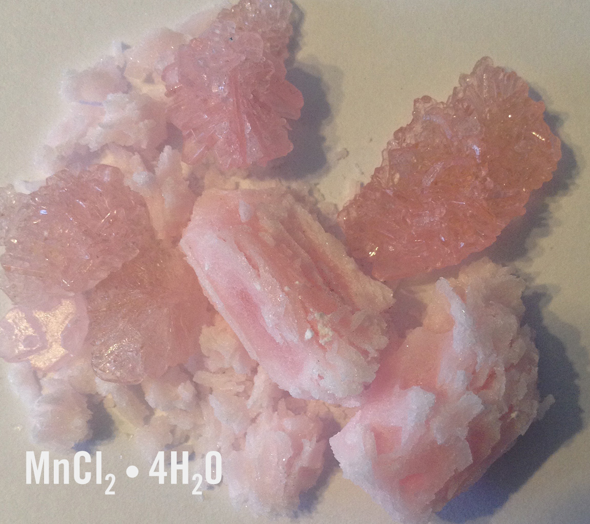

MsSO4 is very pale pink, a most delicate color. Probably your material contains some iron. If you have a soluble thiocyanate salt, you could try adding a pinch of your yellow salt to a drop of fairly concentrated thiocyanate solution. If the impurity indeed is iron, then the drop will turn blood red, even when only a tiny amount of iron is present in your sample. Manganese(II) does not give a strongly colored complex with thiocyanate ion.

I think I can make a nice photo of MnCl2. Mine is nice and pink.
Edit; Mine could also be the sulfate... I haven't seen the bottle in years, but I know where it should be.

Here are some Manganese Chloride I synthesized a few years ago.
There might be a bit of iron contamination, because that was produced from "pottery grade" Manganese Carbonate, and hardware store HCl. But I doubt it because it has the proper color (I synthesized MnCl2 from regular C-batteries a few years back and it had a orange-ish tint)

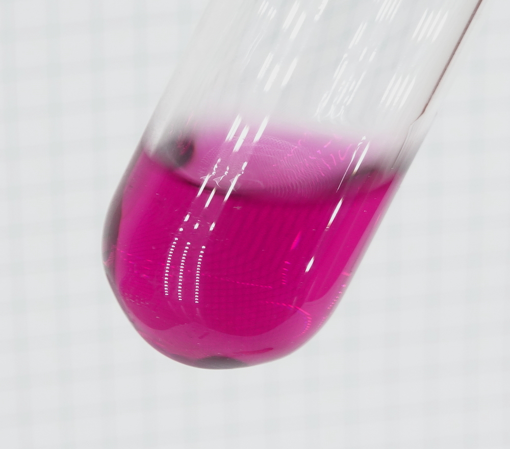

I made some solution of sodium hypomanganate cca 8 months ago. I am really interested in manganese chemistry and I prepared every oxidation state from II-VI from KMnO4. But hypomanganate is really unstable and rare. This makes him really exotic compound.
I made him by reduction of KMnO4 by Na2S2O3 in 48% NaOH. All reagents was cooled in fridge before reaction because hypomanganates are more stable in lower temperatures. In to the solution of 48% NaOH I added few drops of 25% solution of Na2S2O3.5H2O (Na2S2O3 isn't dissolve in water, but in 20% NaOH). Then I added few drops of dilute aqueous solution of KMnO4. Colour of solution has turned in to green by presence of manganate. I returned solution in to the fridge and after ten minutes solution turned colour in to turquoise by presence of hypomanganate. Solution was little bit cloudy, because some NaOH in solution crystallized in the fridge before reaction.
On the internet I found that this compund have really interesting formula Na3MnO4.0,25NaOH.12H2O.
I plan to repeat this reaction in future and test how long solution stays turquoise and some redox chemistry with ethanol and acetone.
In the picture is solution of hypomanganate next to solutions of manganate and permanganate for comparison of colour MnO4(n-).

Very interesting manganese chemistry. I know the green manganese(VI) and made this myself quite a few times, but the bluish manganese(V) I only knew from literature. Never found a way to make it myself, all attempts lead to formation of finely divided solid yellowish/brown manganese(IV) compounds (most likely hydrous forms of MnO2).

I made few experiments until it's finally working. First few experiments stopped on manganate. It needs very strong alkaline media and low temperature.

Hypomanganates is very water sensitive. Trace of water in the air leads to disproportionation to MnO2 and K2MnO4.
[Edited on 17-4-2019 by Bedlasky]
Exactly what happened to mine also i should say manganate is this way also when i saw the sample after a few days it has already went to MnO2 and KMnO4

I made the solution as I described in first post. The problem with stability with solid hypomanganate was that it didn't in extremely alkaline conditions. After reaction you haven't in mixture large amount of carbonate. The yield also dependent on temperature - if it's temperature too high, hypomanganate decomposes.
In cold concentrated NaOH reduction (from my experiences) worked. How much is solution stable I don't know I didn't test it (but I plan it for the future).
