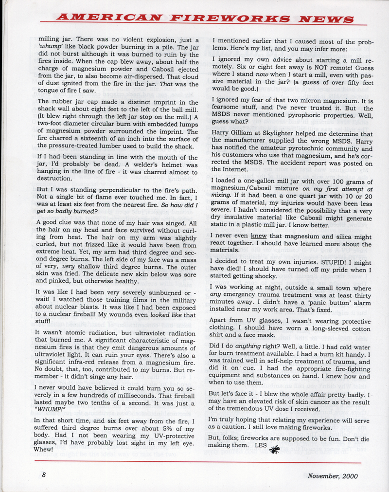

I have heard of incidents similar to this, some causing quite a bit of damage. A particular incident I recall reading a few years back was an experienced pyrotechnic hobbyist, who wanting some ultra fine magnesium, milled some coarser granules to get the desired particle size. Upon opening the ball mill the magnesium dust instantly ignited causing a massive fireball with alot of heat, miraculously the man escaped with only mild burns.
Anyway I would suggest you do this: I assume you are starting with Al foil and milling it down over the period of a few days. I would suggest that you open the ball mill and let the Al powder remain in contact with the atmosphere for an hour or two. Do this once or twice a day until you are done milling. While this may seem counterintuitive it really isnt, aluminum is actually quite a reactive metal and when exposed to O2 it forms a layer of Al2O3 which protects it from further oxidation. So heres what I suspect is going on, as you mill the Al you destroy the passivating layer while at the same time increasing the surface area by alot. So when you finally so expose the ultra-fine Al to atmospheric O2 it rapidly begins to form Al2O3, and after a certain point enough heat energy is released to ignite the Al.
So hope that helps, and be careful.

To prevent its ignition, freshly milled Al should be exposed to air very gradually.
Opening the lid on an airtight container allows air to contact the powder much too suddenly.
After milling, air should be allowed to leak slowly into the container for some time before opening.
This will prevent the sudden oxidation that would heat the Al to ignition.

But a few questions have not been answered and some information is missing. I have milled Al quite some many times with this phenomenon not occurring once.
This problem does NOT have to occur. But much more information needs to be determined.
What was used as milling media?
What was the source of the original Al?
What was the mill container constructed of?
What was the speed of the mill RPM and did was the unit closed to air?
How long did this milling continue unabated?
Was any other materiel used in the mill & was there any materiel added to the Al?
Generally speaking continual milling with no pausing for a moment to open the mill container invites certain problems. Steric Acid used as a mild lubricant is generally standard. Milling media should be altered during the process as what may have been appropriate for tearing the foil and shearing process is not the best for further reduction.
One does not allow the continual mill process to continue uninterrupted for several days on end. The media should be altered. A mild lubricant in very tiny amounts utilized.
If Al foil is used the first step is to reduce it prior to milling and make sure it is really pure and uncoated. Buy the cheapest foil available: it generally does not have a coating of any sort. Then use a scissors to cut that into small sections and place into a blender: this will chop it in to tiny (round) sections that work very well with the STARTING mill process. Use hard surface media first to created a flake shape. Add a very tiny amount of steric acid or similar. Run the mill for 24 hours and open [the container]. Run the mill for 36 hrs and open again. Run the mill for two days max and open each time. Initially heavy glass marbles or brass spheres work very well. Eventually smaller (.5 inch) lead balls are appropriate for extremely fine Al.
NEVER allow the mill to run without opening. Never use a media that may contain other materials (stone, etc). Never use a container that has not been cleaned completely! Slower speeds are actually more effective than faster.
Using foil is a slow process. Floor sweepings from milling is generally very fast materiel to mill. Differing aluminum result in differing outcome. Some is VERY brittle and will granulate rather than flake, eventually getting extremely fine and weeping and surface lubricant. Exposing Al to air allows the oxide to exist: sealing it throughout the process will not.
Mistakes can be overcome IF the process of any synthesis is examined in detail. Energetic materials (Energy experiments in general) are unforgiving. The more research beforehand limits mistakes provided you understand the process and what is happening.
Milling pure Al is dangerous and that is why oxidation is allowed to occur. Keeping the Al from mixing with other materials is also a "no-no", that why everything is cleaned.
With no exaggeration I would say I have milled well over 40lbs of Al & about 10lbs of Mg and not had this problem occur. I have gotten some of the finest Al I have ever examined (under a microscope) via standard methods. This process CAN be done very safely. You MUST examine what you are doing that is causing this to occur! It may be as simple as not opening the container at intervals. Try 12-24 hours continually. Make SURE that everything is unadulterated.
All too often the Al sold on eBay (especially) & by some pyro dealers are adulterated with carbon (often as high as 25%). This is NOT due to some "foil-paper burning process" but simple greed. The older process had perhaps 2-5% carbon that appeared attached to the flake Al. There also was a Al powder than had some Teflon. This was from sweepings from two factories and a great deal of powder made from it. It was extremely dangerous but the opening of the containers allowed oxidation to build and even though the Teflon was there, limited tragic incidents resulted. It was unusually reactive to say the least!!!
-=Work in safety=- NO ONE HERE WANTS TO SEE YOU HARMED! And what's more, you CAN achieve a very safe working condition. It is never a good idea to conduct work in the home. but if no other place is available, never leave anything unattended. If you need to leave. Turn off the mill. If it takes a few more days: so what? Keep you weight levels down until you understand any problems that may occur. Be strictly aware of any fire danger.
You MAY be doing everything correctly and sparking from some source (motor brushes) MAY be the cause of a flash of air-float Al that you simply didn't realize!!! Ask questions: people will treat you with respect. No one wants to see you harmed or your stuff fucked up...

Actually the practice in the pyro community is to keep opening the mill jar at regular intervals. If, for example you mill for a week, make a habit of opening the jar every 12 hours at least, leaving it open for about a minute or two. this will create the oxide layer on the fresh surfaces, but won't lead to ignition temp, as you would get from the huge surface area of 1 week milling time.

Quote: Originally posted by Armistice19
I'm sorry to bother you smarter and more intelligent peoples of the forum, however I am obviously at a lack of preventative safety knowledge. After purchasing my first ball mill a couple weeks ago I began milling some aluminum for flash composition. Each time I milled the material for multiple days in hope of reaching "air-float" German Dark. I am very close to giving up on this sort of thing all together. [snip]

[*] posted on 18-11-2010 at 11:23
Ball-mill-1.jpg - 889kB Ball-mill-2.jpg - 847kB Ball-mill-3.jpg - 813kB
This is your basic thermite® type reaction. A standard lab demo
is to burn Mg ribbon in quartz sand. See also —
William D Jones
The Magnesium + Cab-O-Sil Fiasco
Reprinted in : The Best of American Fireworks News V
(The Best of AFN series can be had from http://www.fireworksnews.com/
donald j haarmann
rec.pyrotechnics
December 8, 2005
"Lloyd E. Sponenburgh" <LLoy...@mindspring.com
| I suspect is was a combination of a localized ignition of a small amount of
| Mg between the balls, along with atomized Mg from the agitation of the
| balls, and (*possibly*) a silane reaction with the SiO2 (Cabosil) in the
| jar.
| I've run Mg in a jar only once -- ONLY once, and I was not milling it. I
| got severely injured. I, too, had Cabosil mixed with the magnesium.
| LLoyd
Silane! Buff and Wöhler's Siliciuiumwasserstoffgas (siliciuretted hydrogen)! I have my
doubts. The only source of hydrogen being moisture and just how the water would be
decomposed remains a question. Burning magnesium and cabosil perhaps could in the
presence of moisture release a combination of any of the 6 silicon hydrides, however,
absenting a lot of water the amounts would not be significant. It is, however, well known that
the mechanical treatment of chemicals can increase their reactivity.
Dropping ball upon balls ... the point contact area cannot be great (I have at this time been unable
to find a equation or table of sphere point contact areas vs. diameter) therefore, a lot of energy
can be generated over a small area by the impact of two balls.

The problem with Lloyd's accident report in AFN as posted by The Wiz is that the "dilutent" that Llyod was mixing with the magnesium was an *OXIDIZER*. Magnesium will steal the oxygen off of many materials that one might normally think to be inert. In this case, cab-o-sil is chemically SiO2...note the two oxygen molecules ready for action.
Commercial aluminum, even the "dark" aluminums, are lightly stearin coated to prevent spontaneous ignition during mfg.
http://www.sciencemadness.org/talk/viewthread.php?tid=14884#...
This has all the earmarks of a Texas tall story. While the intrepid victim
may well have been singed , credibility is lost with embellishment.
" My mill jar was a one gallon capacity PVC jar "
" The mill jar was still on the mill with the quite, green white glow of
burning magnesium emerging from it's mouth. I put out the jar fire
with dry sand "
" The jar - was burned to ruin by the fires inside "
" A welder's helmet was hanging in the line of fire - it was charred
almost to destruction.
" I poured cold water over the burns for a couple of minutes until
fires caught my eye. There were several small fires burning in and
around my milling shack."
- Although PVC is intrinsically fire retardant because of it's
relatively high flash point ~ 435 ºC and 57% of it's weight is Chlorine,
the heat of a magnesium flare would liquefy and ignite the container
with napalm like combustion. Even with the shack open , 2 minutes
is the mean time for flashover and conflagration of everything. The
events as described don't correlate intense heating with little fire.
http://www.chemexper.net/specification_d/chemicals/supplier/...
( It should be noted that PVC , magnesium , and a nitrate salt constitutes
tracer composition for rifle ammunition )
http://tinyurl.com/366allw
http://tinyurl.com/393fprh
" my arm had third degree and second degree burns. The left side of
my face was a mass of very shallow third degree burns. The delicate
new skin below was sore and pinked , but otherwise healthy."
- Although the writer goes to extensive detail of his injuries no where
is there any mention of the scabbing which must necessarily occur to
be consistent with what is claimed.
- Third degree burn means total loss of skin requiring grafts to replace it
and hospitalized in an intensive care burn center.
" I went through Special Forces training in the Navy "
- Huh ? Special Forces is an army outfit. Generically " Special Forces "
refers to Navy Seals also but it is seldom referred to as such , and while
many military branch facilities provide interservice training , basic survival
skills are service specific.
" They also taught us how to recognize shock in one's self , and
how to treat it."
" the next day I saw a doctor - " Damn Lloyd ! You could have died !
I've seen people die from shock with less than this ! "
- Shock is the medical term for excessive blood loss. Had the ' doctor '
received Special Forces training also he would have known that.

Seems like nitpicking. Sure, he may not in fact have had third degree burns to the extent claimed. His 'couple of minutes' might have been only 15 seconds - who knows how someone's perceptions of time would be affected in that situation?
As for the rest, it seems like
- the SEALs might not have existed under that name at the time that he would have trained
- almost the entire reaction would have occurred outside the PVC jar (that being where the oxygen was), limiting its involvement
- 'shock' does not necessarily imply blood loss; you sure can get shock from being badly burned; and even if there is some narrow medical definition that meets your criteria there's no reason a doctor couldn't have been speaking colloquially.
In short it seems like you're grasping at straws to throw doubt on a perfectly plausible story.
The fellow who relates the story is the author of the book Ball Milling Theory and Practice for the Amateur Pyrotechnician. In it he describes the construction of mill jars from PVC plumbing pipe and standard fittings. His one gallon jar has a main body of 6" diameter pipe, 8" long.
grndpndr
Posts: 508
Registered: 9-7-2006
[*] posted on 23-11-2010 at 12:06
FWIW Franklin has some valid observations.2nd/3rd degree burn victims of the degree described aren't sent home with antibiotic cremes etc to care for themselves.Home care and recovery:o
I wont bore you with military terminology/history but rest assured a Navy SEAL would never refer to himself as SF and vice versa.
I cant comment on the rest of his story but the military and injury parts of the story sound like artistic license to me.:D
