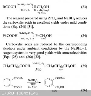

You might get a chance to oxidise benzyl alcohol to benzaldehyde in a dry solvent. Aldehydes react with water to form hydrates (diols)
-COH + H₂O ⇌ -C(OH)₂ + H⁺. This reaction has not a very high K, so the amount of diol formed is minimal, but the oxidising agent will attack the diol to form the carboxylic acid: -C(OH)OH → -C(O)OH, and since this reaction is not reversible, it drives the former ahead, progressively oxidising all the aldehyde into the carboxylic acid.
You can try PCC in DCM. I even saw a paper about oxidising benzyl alcohol to benzaldehyde using bleach and a phase transfer catalyst (TBAB in this case).
Reducing a carboxylic acid can be done with lithium aluminium hydride, that brings you back to the alcohol. Granted LiAlH₄ is not easy to source.
You can use the easier to source sodium borohydride with zinc chloride, apparently. See attached document.
I wonder if sodium dithionite would work. It is known to reduce aldehydes to alcohols above 80°C, so that might work.
In any case, all these reactions would bring you back all the way to the alcohol. I don’t think it’s possible to stop at the aldehyde level, given the reactivity thereof.
