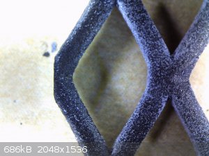

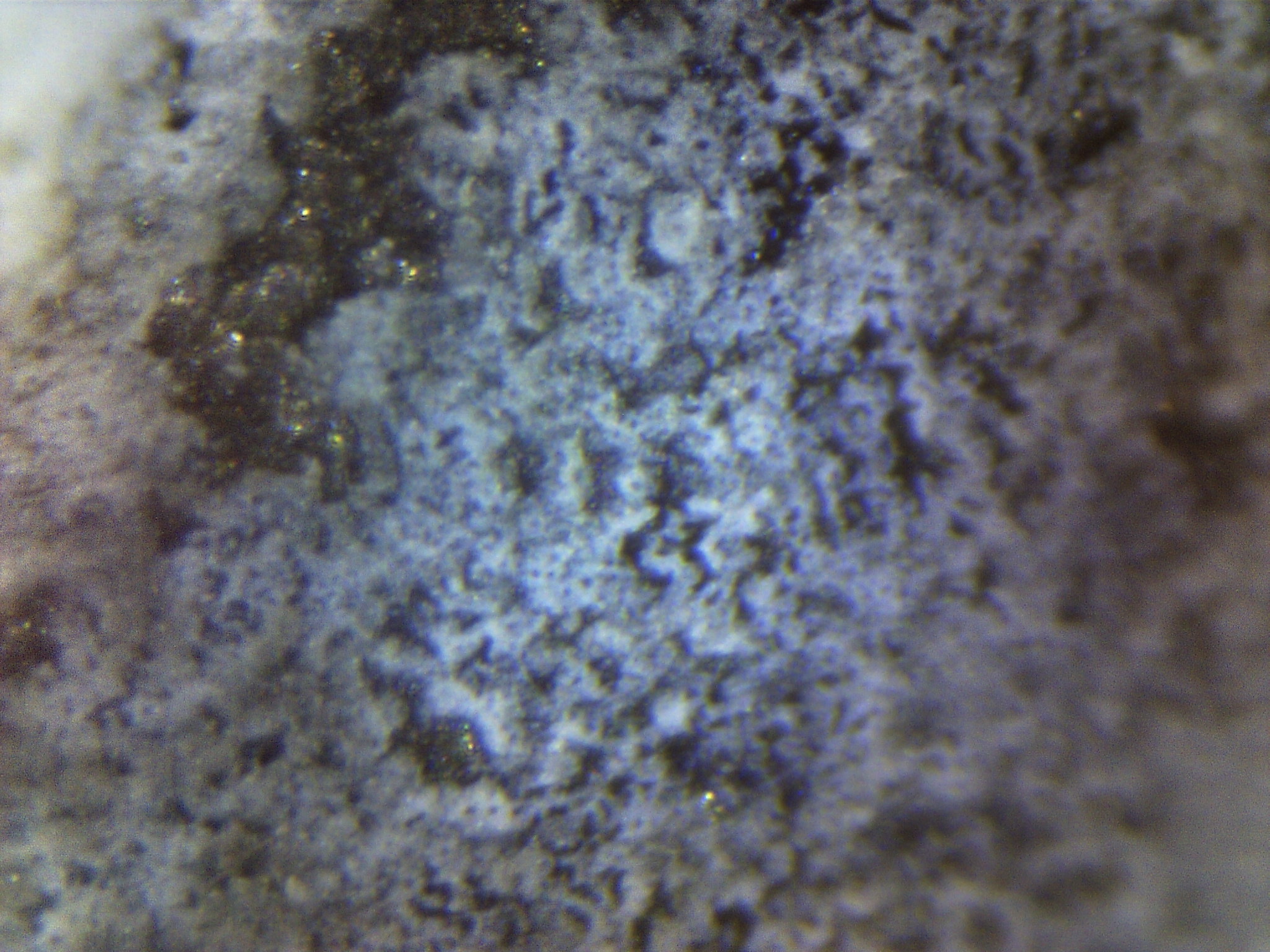

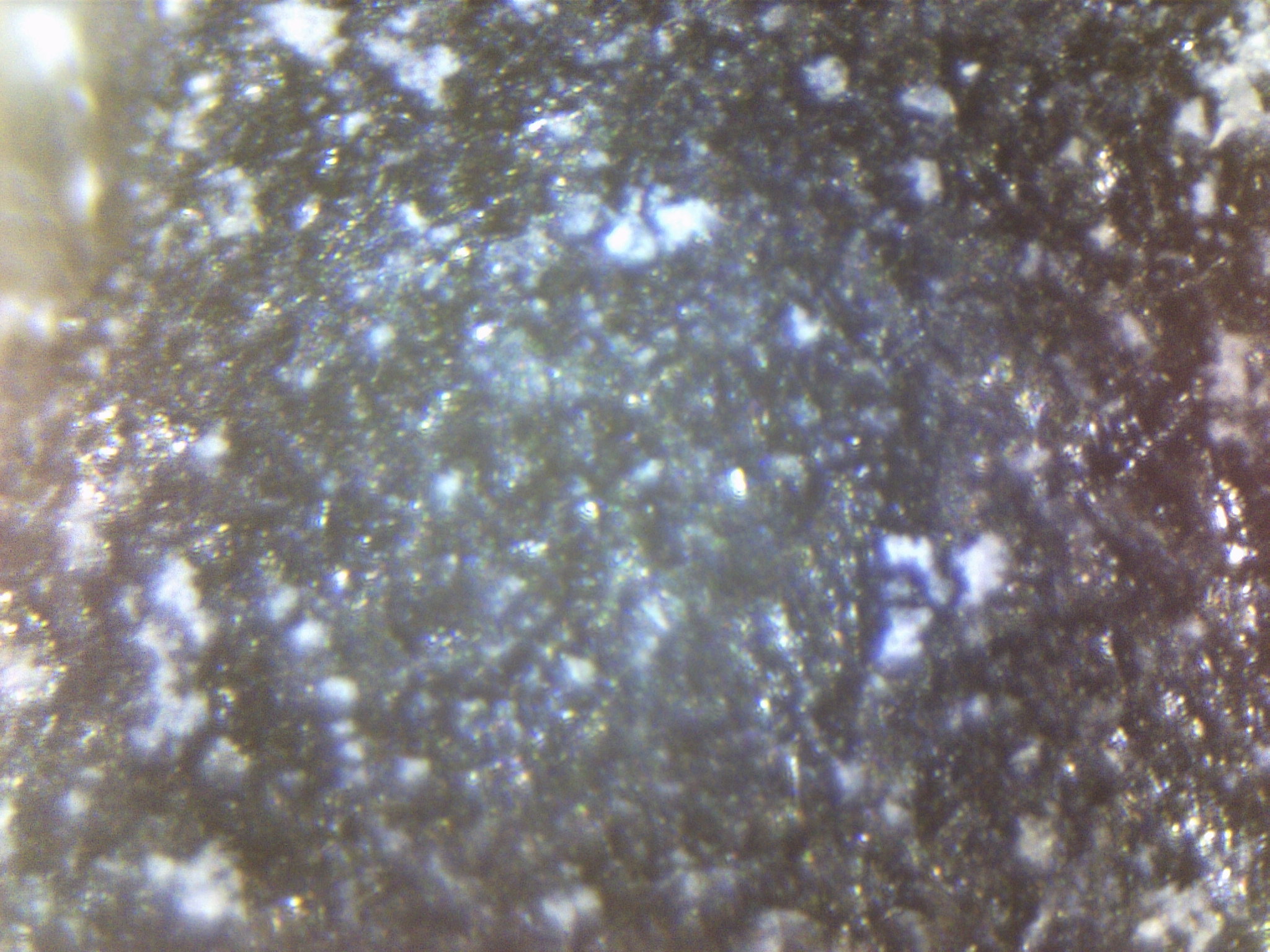

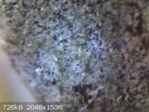

[*] posted on 23-2-2015 at 21:02
I just put the anode under a microscope. I'm pretty sure now the white layer is a deposit, instead of a place where the MMO was stripped away.
I also tried 800 grid sand paper and a screw driver to clean it, but it's not possible without severely chipping off the MMO.
Can anyone identify what the mystery substance that resists all the cleaners I've thrown at it (HCl, NaOH, acetone)?
cleaner, wide angle
clean_wide_angle.JPG - 686kB
cleaner close up 1
cleaner1.JPG - 711kB
cleaner close up 2
cleaner2.JPG - 685kB
dirty, wide angle
dirty_wide_angle.JPG - 685kB
dirty close up 1
dirty1.JPG - 726kB
dirty close up 2
dirty2.JPG - 709kB
[Edited on 24-2-2015 by UncleJoe1985]

UncleJoe1985
Posts: 88
Registered: 30-9-2008
Location: Sunnyvale, CA
biggrin.gif posted on 3-6-2015 at 03:00
Victory! My anodes have been resurrected! :D
It was quite simple - just soaking the anodes in an initial 5% solution of NaOH at 80C for 2 hours. Although tried NaOH before, I missed the importance of high temperature and time.
current measurements (5V, saturated NaCl solution)
new: ~10 A
dirty: ~2 A
cleaned: 4.5 A
I only did a crude current test and probably didn't have good electrical contact and had a larger distance between electrodes than in the actual cell. So the current might be bigger than 5 A. However, I'm expecting a large drop from 10A due to my earlier abusive cleaning efforts.
That anode is moot since I'm using a much bigger one now:
anode.JPG - 184kB
It only took 1 month for this anode to passivate (go from 18 amps to 5 amps)! I cleaned it the same way and was able to get 9 amps (again, it's probably higher due to the crude testing).
Here are some photos of the smaller, cleaned anode.
You should see a big difference compared to my earlier photos
after cleaning
180918.JPG - 373kB
after cleaning, 4x zoom
after_NaOH_cleaning_wide_angle.JPG - 981kB
after cleaning, 54x zoom
after_NaOH_cleaning_closeup.JPG - 831kB
My conclusion?
It's the wrath of calcium silicate! :o
The Morton salt I'm using has calcium silicates to prevent caking. I don't know much about silicates but it seems they're glass like and insoluble. But I suppose the basic pH of most amateur cells could dissolve trace amounts of it. And since molten NaOH will utterly dissolve glass, it totally makes sense that a hot solution of NaOH will dissolve the deposits.
I received tremendous help from the "Effects of Electrolyte Impurities in Chlorate Cells" by Richard A. Kus referenced earlier in this thread. It mentioned silica in several places. Appreciate it.
It would be great if someone else can try this and report how much it helps.
[Edited on 3-6-2015 by UncleJoe1985]
