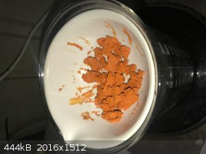

I had a go at making antimony sulphide more or less based on patent Patent CN102259912B
https://patents.google.com/patent/CN102259912B/en
although I must stress 'loosely' as I did not have all the exact compounds specified.
- 5.1g Sb2O3 and 18g concentrated HCl placed in a beaker, stirred and heated (patent called for Sb2O5 but I did not have any).
- Once hot (not boiling) the oxide dissolved reasonably fast, into a clear solution.
- Add 3g tartaric acid and stir till dissolved.
- Let solution cool to below 50 and then add equal volume of water. At this point the solution became cloudy, with a white ppt. I dont think this was supposed to happen, I probably added too much water or the temperature should have been lower before adding the water?
- Filter the solution, obtaining a clear filtrate and a little bit of white remainder.
- Dissolve 7g Na2S in 30ml water (patent calls for ammonium sulphide but I did not have).
- Drip the Na2S solution into the SbCl3 solution with fast stirring.
- An orange suspension quickly formed. Initially there was no H2S smell, but when about 75% of the Na2S solution was added it suddenly started to make bubbles of H2S as more was added. I assumed this was the point where all the SbCl3 was displaced and the Na2S was started to react with the excess acid, so stopped adding Na2S.
- Transfer to large beaker and add 400ml water, stir, let settle, decant, add water, stir, settle, decant.
- Transfer remainder to vacuum filter and wash again in funnel.
- In solution the volume of the remainder looked huge, not so much once filtered and recovered to a crucible.
1.jpg - 444kB
- Dry the product on a steam bath until the weight was stable. Pulverize in a mortar.
- 3.6g of soft orange-brown powder recovered. This is a yield of roughly 50% based on the initial amount of Sb2O3.
2.jpg - 369kB
Cleaning: This stuff is fine and sticks to everything. Best way I found was to wash with water, then clean with paper towel, then rinse with concentrated HCl. And get a whiff of H2S a few times as the acid reacts with the antimony sulphide.
It is mentioned online that a golden color is also achievable. I think this reaction will yield many different color shades depending on ratios, temperatures, starting materials, stirring rates etc.

I actually think that you have a nice result. Yield probably could be a little better, but your product looks nice. I myself made Sb2S3 many times, but never took the effort to isolate it and dry it. I also purchased Sb2S3, but that is the crystalline black material. The black material is much less reactive than the orange material, that's why I made the orange compound several times as a basis for other experiments. The black crystalline solid appears to be only marginally interesting. It seems to have applications in pyrotechnics, but I don't do that and then not much remains to be done with the black material.
I do not understand why the patent calls for Sb2O5. Isn't that a mistake? Sb2O5 is oxidizing and if you dissolve that in acid, you get antimony(V) in solution, which will oxidize sulfide to free sulfur. Your product then will be strongly contaminated with sulfur. So, you did the right thing to start with Sb2O3. Btw., I have some Sb2O5, and this stuff is MUCH more inert than Sb2O3. Dissolving even a tiny bit of this compound in conc. HCl takes ages, even when boiling and fuming you workspace with HCl.
