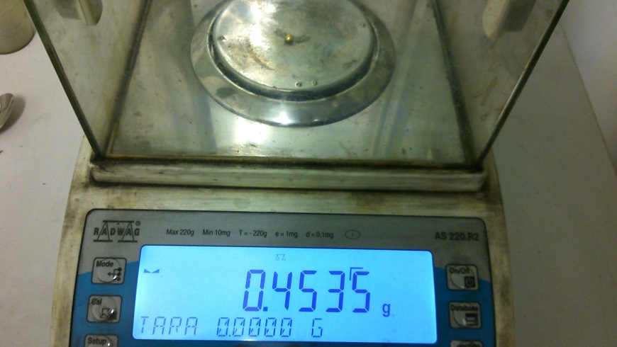

So one day I decided I have too much money (yeeeeaaah, sure) and I bought some 14k (583) gold scrap, and decided to get the gold out.
Here I need to thank the kadriver/sreetips/bafelous for his very informative (even if long) YT films. They (with topics on goldrefiningforum) saved me much time and effort.
Gold was inquarted with silver and melted in a furnace. Remember - mix it a graphite rod or something similar, or else your metals won't alloy properly (own experience).
//Also, now I think that it would be better to use a torch rather than furnace - as soon as the crucible is taken out, it cools and some of the metal sticks to the walls and can cause losses. Of course, you can later digest the crusible in HNO3 and then aqua regia, but it's easier to avoid metal sticking to crucible walls, I think.//
The melted alloy was poured into metal can with water, and then digested in hot, dilute (ca. 20%) nitric acid. Acid was decanted, metal residue treated again with hot nitric. Then again, cooled, decanted and washed two times with distilled water.
//This was also the moment I realized that my distilled water contains chlorides, crap. Nitric acid used earlier was diluted with 3% H2O2 to reduce it's amount required for digestion.//
Then, the metal that turned meanwhile from silver to brownish colour was covered with conc. HCl and part of calculated conc. HNO3 amount was added. Solution upon heating quickly turned yellow-orange, and brown gasses evolved. HNO3 was added carefully until all the gold dissolved and no metal particles was visible; the solution was slightly turbid due to presence of white AgCl. Diluted the solution with water to decrease the AgCl solubility. Reaction mixture was left to cool, AgCl sedimented. Filtered off the sediment, heated the clear solution to concentrate it by evaporation.
Added 1g of urea to reduce the HNO3 possible leftovers. Added excess of ascorbic acid, gold precipitated as dark, fine particles, solution turned dark brown due to degradation of ascorbic acid. Mixture was left to cool, filtered and dried.

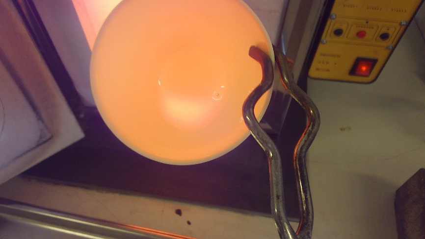

Prepared the porcelain dish //actually a wide crucible, but whatever// by glazing it with borax to prevent the gold from sticking to a porcelain. The filter with gold precipitate was put into the dish, burned in a furnace and melted. While the borax was still melted, took out the gold drop with metal tweezers. and put it into cold water. Scraped away the leftofers of borax, washed the gold drop, dried it and weighed.

Did you weigh the gold before you started and calculate a yield ?

Total initial amount was 1.96g of 583 gold, output of two batches is 1,139g. I estimate actual loss for ~10mg, however I located a tiny gold particle stuck to crucible I used for final melting (the one in the photo above). I'm trying to recover the residue from crucible used for inquartation; probably there hides the rest of my gold.
What is the average gold content in your e-scrap? What type of e-scrap was it? In mine (whole different story, I'll post it someday later) it was about 25ppm.
And how fine your dust is? Something like in my pic or bigger?
