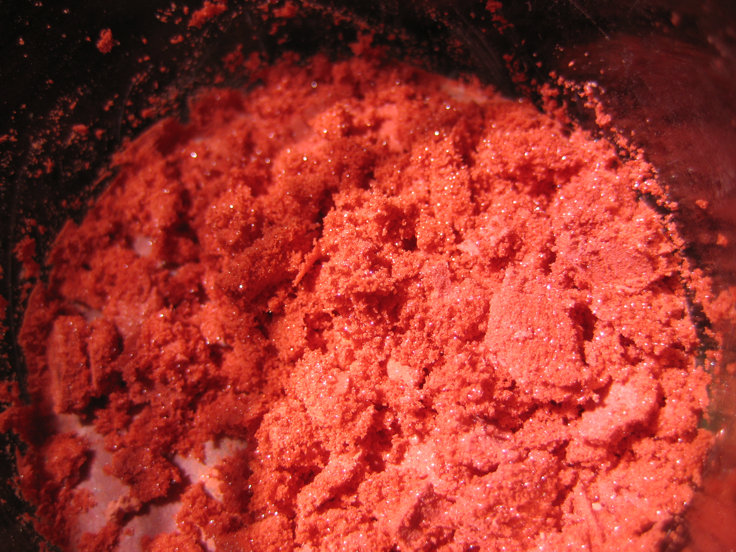

What about Reinecke's salt?
Possibly one of the nices reds I have ever had.
IMG_6181.JPG - 3.2MB
