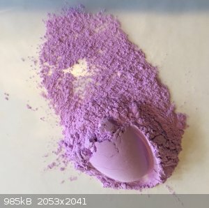

With NHN high temperature is a must. Without high temperature, the NHN produced is amorphous in nature whereas the
materials prepared at 65◦C are granular, free-flowing. 13 µm is the average particle size of NHN according to literature and observation. I used to make NHN without dextrin and it didn't perform as well.
NHN produced at 65°C
65c NHN.jpg - 985kB
NHN produced at 25°C
25c NHN.jpg - 632kB
Rosco Bodine
Banned
Posts: 6370
Registered: 29-9-2004
Mood: analytical
[*] posted on 18-2-2020 at 14:06
There is no contradiction in what you have observed. The concentration of a reaction mixture and rate of addition, generally are inversely proportional and act counter to increasing crystal size while temperature increase promotes larger crystals.
Greater dilution, slower addition, longer reaction time, higher temperature, and more turbulence to keep precipitates suspended instead of forming "sand dunes" on the bottom of the reactor promotes crystal growth to larger size, and generally the reverse of those factors results in much smaller crystals.
You could try 90 C and see what results at half the concentration with half rate of addition and 4 times longer reaction time with increased turbulence if needed...to see if there is any difference. But a disadvantage is that yield can suffer when a reaction is not being optimized for yield but for a specific physical form for the product. So what is an optimal synthesis can be a tradeoff to find what is most practical.
