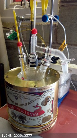

Posts: 3443
[*] posted on 11-2-2020 at 03:01
Is it cheaper to buy or make hot plate magnetic stirrers?
Yes
___________________________________________________________________
You can buy hotplate stirrers of various brands, new, used, abused or scrap value.
You can build a hotplate stirrer from exotic custom made materials or from existing scrap items.
Generic domestic electric hotplates are cheap when new, even cheaper used.
For better heating control use an electronic 'dimmer' module.
Overhead stirring was very cheap for me because the motor was free - from a broken hand blender,
I had clamps, stands, power supplies etc.
(a laptop charger plus pwm module would work)
so I only needed to purchase the shaft coupler, shaftwith ptfe stirrer and stopper/bearing.
Not ideal but it works https://www.youtube.com/watch?v=ziRxiFSaZsA
(a second clamp for the stopper helps when stirring in beakers).
Similarly, a diy heating mantle can be made quite cheaply,
e.g. my cake-tin 500ml heating mantle, almost complete, being tested.
(I enclosed the pwm controller and spray painted the tin grey sometime later.)
500ml_Mantle_Test3.jpg - 1.6MB
DIY or Buy, which is best ? ... depends .......
