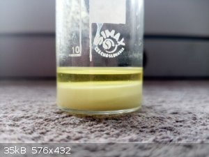

dissolving W in H2O2
Here my experiment - dissolving tungsten in hydrogen peroxide. Unfortunately there is no info about stabiliser in H2O2 but there must be some as the bottle is 15 years old, the concentration at the bottle label is 30% and analyzing it (volumetric) the concentration still exceeds 30% (while my other only 3 years old pharma grade 3% H2O2 bottle contains almost no H2O2 - I believe that pharma is unstabilized H2O2).
To the testing tube 5 ml of 30% H2O2 (0,0500 mol) was poured, then tungsten (99,8%) welding electrode (TIG) inserted and was let to react at room temperature for 3 weeks. Peroxotungstic acid is better soluble in water than tungstic acid so at the end of reaction when H2O2 was consumed up the H2WO4 started to precipitate.
The electrode was removed from the testing tube while spattering it with H2O using a syringe and dried out. The testing tube content was mixed well and quickly transferred into 25 ml beaker (the product has quite high density and settles readily), testing tube flushed with few ml of water, which was added into the beaker and the product in the beaker was let to dry out at room temperature for few weeks.
The electrode weighed 107,4 g initially and 105,1 g finally.
2,3 g of W dissolved, molar mass 183,95 g/mol which means 0,0125 mol. So most of H2O2 reacted (0,0375 mol) and only little of it decomposed (0,0125 mol) - there is still some pertungstic acid present so the amount of decomposed H2O2 is even less than that 0,0125 mol.
W + 3 H2O2 -> H2WO4 + 2 H2O
the reaction after 3 weeks at room temperature (for first weeks it was only boring very pale yellow clear solution)
IMG_20200211_145447_8_sm.jpg - 39kB
drying out the product at room temperature
IMG_20200216_102011_5_sm.jpg - 39kB IMG_20200216_102020_0_sm.jpg - 35kB
