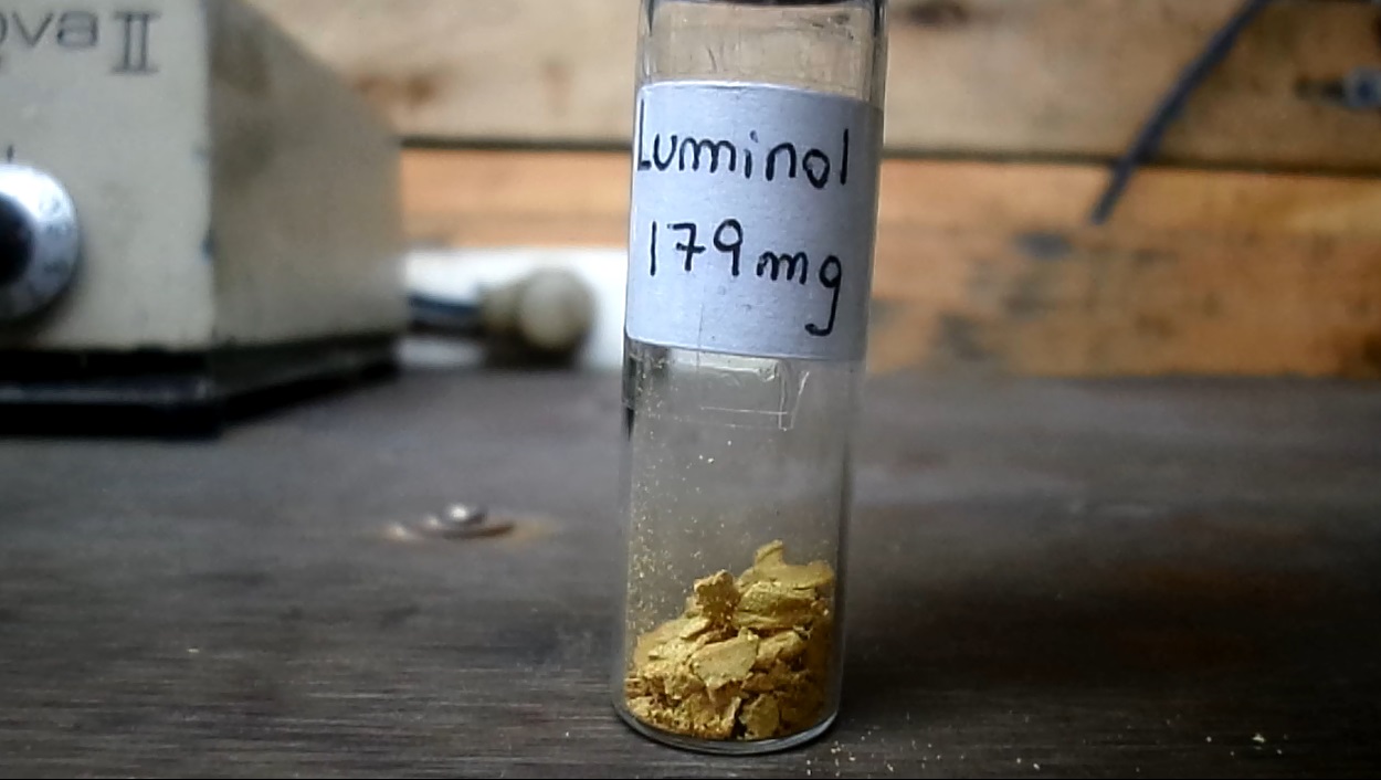

USING SODIUM SULFIDE LAB GRADE
In a reflux apparatus was added 3g of 3-Nitrophthalhydrazide, 9g of Sodium sulfide and 30mL of water Approx. The mixture turns dark red as the alkalinity of Na2S dissolves the nitro compound, these was put to reflux for 3hs (The color doesn’t change that much). After reflux the mixture is acidified with 7M HCl while hot, SH2 is liberated, and precipitation of luminol and sulfur occurs, the solution is placed in the freezer to cool.
After cooling the precipitate is filtered, and while slightly wet it’s placed in a beaker and luminol extracted with hot ethanol in 2 portions, 100mL and 50mL respectively. Filtration of the hot ethanol separates the undissolved sulfur. Cooling of the ethanol precipitates luminol, filtration and drying gives 179mg (6.8% yield) of Luminol contaminated with some sulfur. I know... These sucks, in the comment section you will see why these happened.

First of all... during the reflux of the reaction A LOT OF THINGS HAPPEN... a solid forms in the condenser (maybe ammonium sulfide?), some yellow liquid refluxes (WHTF .. yes .. but it happens !!)
It might look as if the “Crude” amateur second procedure is better, but in fact I made a HUGE MISTAKE in the first procedure. I did the reaction about 3 times using pure lab grade sodium sulfide, and it was at the 3rd time I realize I was an idiot. The yield of my 3 attempts was always bad and I couldn’t understand why if the paper claims more than 60% yield, I even used a 3g run and still got it wrong, so I check stoichiometry and was Ok, check reactions time and was ok … I was using sodium sulfide instead of ammonium sulfide and the Sulfide was the important ion, I had good yield with nitrobenzene in similar conditions in the past so… what was wrong??? It was when I check the mechanism of the reduction that I realize … yea I am a total idiot. The ammonium ion in the ammonium sulfide is actually an important component!
The proposed mechanism for the reduction of NITROBENZENE is the following
Nitrobenzene Reduction Reaction Mechanism.png - 25kB
Yea I know these is not 2-Nitrophthalhydrazide but the mechanism is the same, the important detail is that for the reduction to occur there must be protons! Ammonium Sulfide is 1000 times more acidic than sodium sulfide, these is because Ammonium ion has the following equilibrium in solution.
NH4(+) + H2O ↔ NH3 + H3O(+)
(I know the symbol is not of equilibrium, I didn’t find the symbol in word xD xD)
So pH was the problem … Yea these is classic amateur mistakes (or maybe it’s just me xD feel free to criticize) once I added the Ammonium sulfate as a source of ammonium ions the reaction was more efficient. Unfortunately from the 8,5g of 3-Nitrophthalhydrazide I made in 1.5 weeks of work I used 6 of theme in failed attempts... I feel an idiot but it’s nice to know at least I realize my mistake. What’s also nice is that the procedure with sulfur work’s and is a nice way to make the reduction, I can’t find sodium dithionite or thiourea dioxide to do the other more classic reductions so I had to try these ones.
A note on the Luminol Purity and purification, using ethanol is actually a bad idea in the first place, as some sulfur does dissolve and precipitates along with luminol. The best purification is to add small amounts of sodium carbonate (Na2CO3) while cool and check the pH, filter off the sulfur and re-precipitate the luminol with acid, I did not do these because the first time I tried it I had a bad luminol yield and also bad quality so that kind of pushed me away from the procedure. But at the end I got all my Luminol from the attempt’s and did the purification wit carbonate and went well with nice and yellow luminol as the final product.
