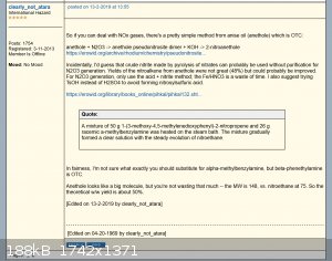

Anethole is way cheaper than silver and nobody ever seems to think about the anethole pseudonitrosite method. Only sodium nitrite is required. The only other difficult chemical needed for the pseudonitrosite rxn is diethyl ether. Shulgin demonstrated the retro-Henry reaction using alpha-methylbenzylamine but I imagine you could get pretty similar results with beta-phenethylamine or any of the other known methods for hydrolysing a nitroalkene.
There is also a direct anhydrous cleavage of nitroalcohols:
https://www.thieme-connect.com/products/ejournals/pdf/10.105...
I am not sure if copper in wet conditions could catalyze the same thing but it seems interesting.

JW: I'm not sure why the anethole method is so unpopular.
The pseudonitrosite reaction for nitration of styrenes has been developed extensively by... well, let's just say... entrepreneurs. It's easy to find a number of amateur reports if you Google "pseudonitrosite erowid".
The "Pseudonitrosite FAQ" describes alkali workup of the initial addition product in alcohol:
https://erowid.org/archive/rhodium/chemistry/pseudonitrosite...
"0.1 mole of the corresponding propenylbenzene pseudonitrosites (28.5g asarone, 23.8g isosafrole or 22.4g anethole) was dissolved in 150ml 8% alcoholic KOH with shaking, and possibly light heating (not over 30°C, especially not in the case of asarone pseudonitrosite, or there is a risk of decomposition (to the aldehyde, amongst other things)."
It appears that simply warming up the reaction mixture is enough to cleave the nitrostyrene, at least if there is sufficient water available for the hydrolysis reaction. If the aldehyde is subsequently immobilized by adding bisulfite, it should be possible to obtain the nitroethane directly from this reaction mixture. KOH will deprotonate nitroethane, so it should be carefully neutralized (e.g. AcOH, not HCl) to prevent a Nef reaction.
Just a quick comparison of molar masses:
Silver: 107
Anethole: 148
so overall you need 1.4 g of anethole to replace 1 g of silver, which means it really isn't that inefficient.

This thing, as you've posted it (and I've looked into as well), is rather "Hivey".... like you did mention. Nothing wrong with that at all, but some stuff there is a bit shaky on the details.
This one seems decently descriptive though. I can see the Nitropropene angles for their purposes, and I suppose by decomposing / hydrolysing at the end I'd essentially be "ruining" the proposed drug synthesis and ending back up with the 'starting' nitroethane, insofar as 'starting' can be ascribed.
I like the idea of using bisulfite to adduct out the aldehyde right in the same pot too, then filtering, seems slick.
If you add in the electro-synthesis of nitroethane (oh yes, I'm totally going after these 2 sentence throwaway blurbs from 1895 involving sodium propionate and sodium nitrite I saw in a google book search baby!!), I'll have my hands full!!
