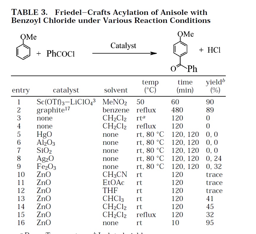

Caveat Emptor on Iranian chemistry IMO, but give this a looksie:
Uses Zinc Oxide instead of AlCl3 or fancy pants stuff.
Attachment: sarvari2004 - friedel with ZnO - Copy.pdf (73kB)
This file has been downloaded 590 times

Thanks. I like idea of using zinc oxide as catalyst.
If we are talking about Friedl-Crafts acylation is there any healthier alternative to chlorinated solvents for this reaction?
Sarvari uses NO solvent for a few of the reactions, and of course, these solvents:

I'm curious why acylation with ZnO does not occur in ethyl acetate.
