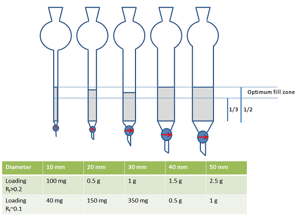

My column has an ID of about 16mm at a guess any idea what sort of loading I can apply in terms of how much of my mixture I can treat in one pass?

[*] posted on 17-6-2020 at 03:24
Column_sizes_loading.gif - 32kB

[*] posted on 17-6-2020 at 03:30
It does depend on how good a separation you get though. If well resolved you might be able to exceed the loading on Ubya's graphic by a considerable margin.
