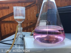

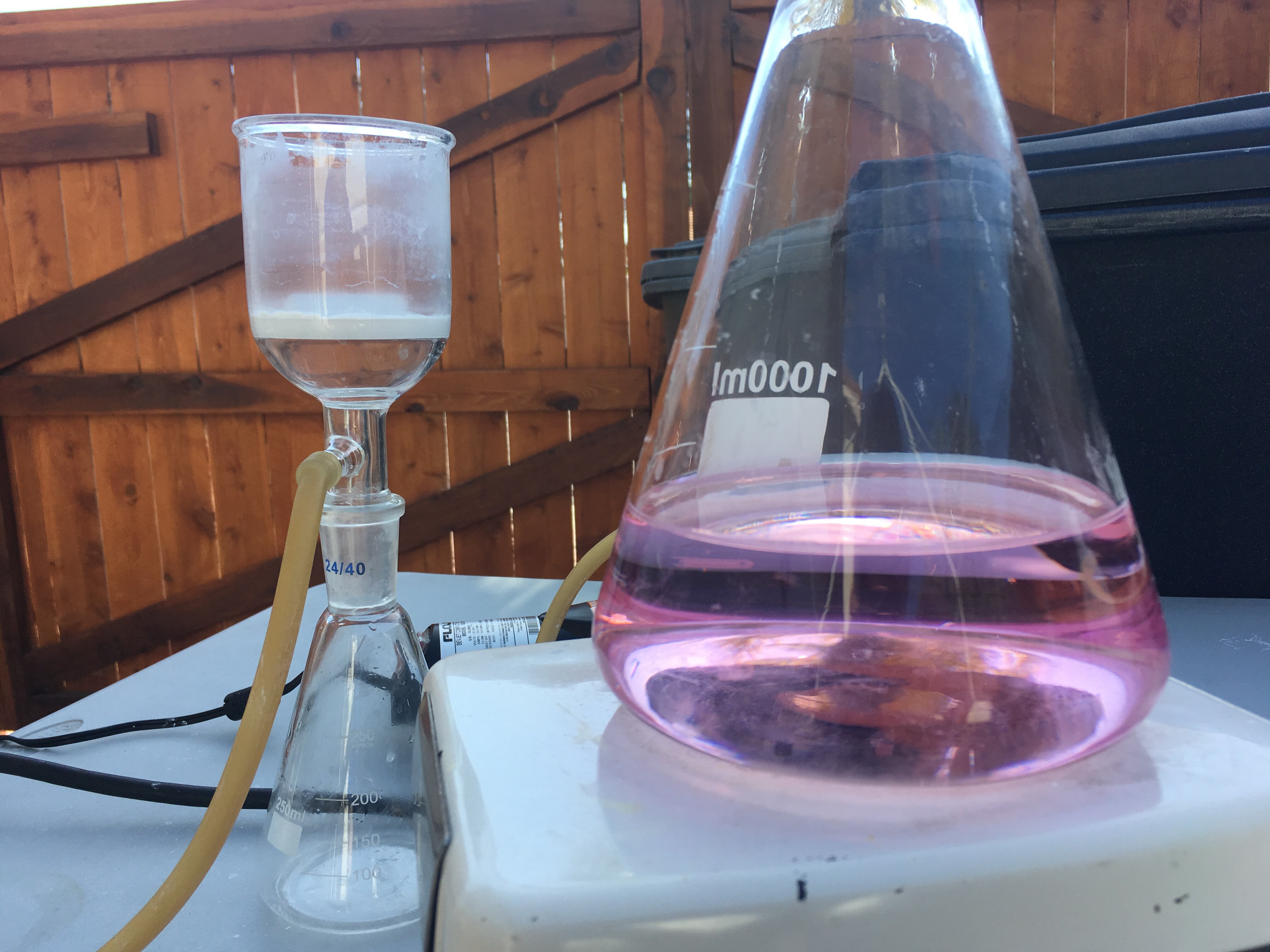

Once the hypochlorite is added, the mixture rapidly turns red, as you can see above, before the red color disappears over a few minutes with some bubbling. Once the suspended solids are filtered off, the filtrate has a lavender color which I think is from Mn impurities in the calcium hypochlorite being oxidized to permanganate, which you can see in this image.

At this point, the filtrate appears to have a pH of 11-12, but the test strips are very rapidly bleached so I dont know for sure. I boiled down the liquid, and near the end the lavender color rapidly disappeared. Once it cooled down, which you can see in the image below, there were a few crystals that fell out of solution. The pH was now 6-7, and it no longer rapidly bleached the strip of pH paper.
