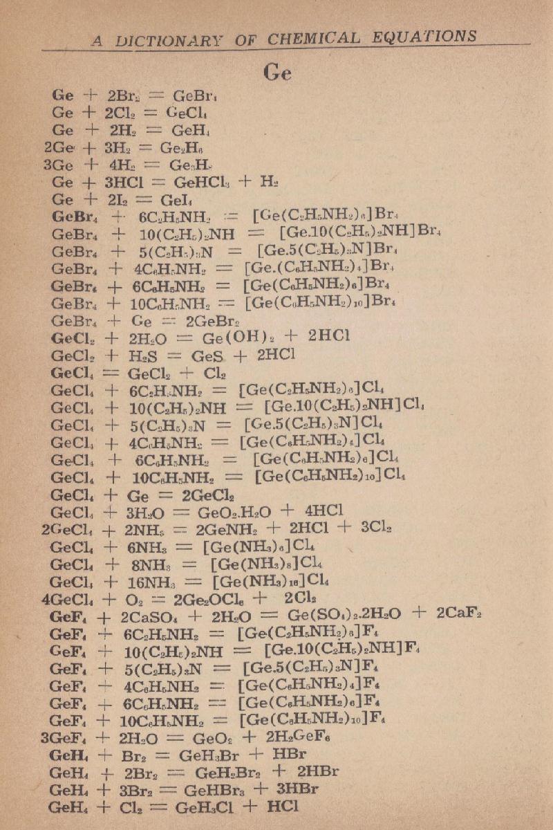

Maybe I missed it in 3 pages but I am unsure what compound of Ge Mixell is going for. Back in my youth with no internet and no information (or very little) on Ge chemistry I was trying to alloy Ge. OK, so I thought it would act like a metal, and if I could liquefy it I was going to melt other metals into it. Heating a 50 gm chunk of pure Ge in a ceramic boat (no flame touching Ge), it began burning in air. Much like a Mg fire I might add. Clouds of smoke later I had a powder with both yellow/orange and white appearance. Reading about toxicity of at least one Ge - Oxygen compound I left the room, open for a half day. Still alive all these years later. Anyway, was wondering if this carried out in a fume hood to give an oxide of Ge would not be a simple, fast starting point to then further react the powder to form other salts of Ge? Much of the Ge went out the door as oxide smoke so possibly routing this smoke through another vessel with the reactants needed for some other transition might also be a viable procedure?
The Jpeg's below show the only information I possessed back then about Ge chemistry, might still be of use here.
Ge1r.jpg - 179kB Ge2r.jpg - 127kB
