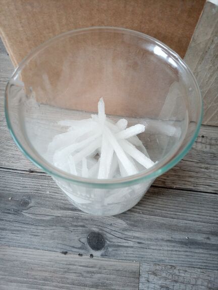

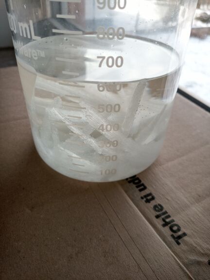

I have cca 10 kg of ammonium nitrate with dolomite fertilizer (75-80% AN + 20-25% dolomite).
I dissolved some fertilizer in water (lasts longer as it is very endothermic), let to settle dolomite in a flask, carefully slowly dropwise siphoned the clear liquid using a narrow hose. Added 1 ml of 24% ammonia and let in open beaker to allow CO2 to enter and precipitate CaCO3 and MgCO3 from contaminants Ca(NO3)2 and Mg(NO3)2 coming from dolomite reacting with acidic AN. Then filtered and evaporated some of the water on my stove while burning wood during cold outside weather, but did not concentrate too much (small crystals from too much concentrated solutions). Then let overnight outside at 0 C. These beautiful big crystals grew in 1 L beaker.
I decanted the mother liquor and I'm going to concentrate it to obtain second crop of the crystals and very likely third, fourth... crop then. I won't concentrate it too much, I plane to evaporate approximately 100 ml from current 600 ml every step and then cool down to 0 C.
IMG_20210408_075909_0_sm.jpg - 31kB IMG_20210408_075931_1_sm.jpg - 32kB IMG_20210408_075942_5_sm.jpg - 30kB IMG_20210408_080256_0_sm.jpg - 39kB IMG_20210408_080320_3_sm.jpg - 40kB
[Edited on 8-4-2021 by Fery]
