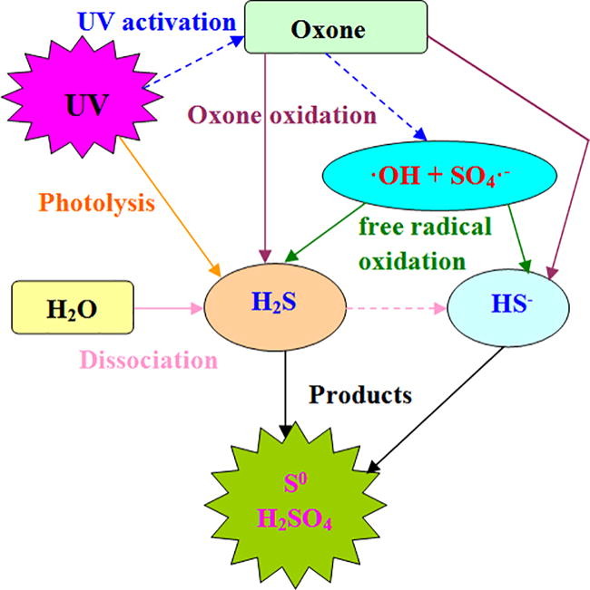

Here's a novel gas scrubbing system utilising UV & Oxone which might be of interest to the Euro folks..
https://www.sciencedirect.com/science/article/pii/S138589472...

That sounds very useful. I'll be sure to try it out once I have a fume hood, in case anything leaks.
Maybe it'd also be a useful route to sulfuric acid?
S + [Metal] = MS
MS + [Acid] = H2S
H2S + KHSO5 + UV = H2SO4

You can make H2S directly S +Paraffin wax + heat = H2S
Regarding synthesis of the sulfuric acid even if it could be performed in an amateur lab it is much easier, cheaper and safer to just buy sulfuric
acid, if you need only small amount of it you can use an old amateur method, electrolising CuSO4 solution using lead electrodes or if you
really want to make your own acid I would rather opt for oxidazing SO2 using metal oxides, Fe2O3 works reasonably
well, hell, you can even buy V2O5 since you need only catalytic amounts.
Also, note that this paper is written by the Chinese they are known for submitting flawed or fabricated results and generally can not be trusted.
