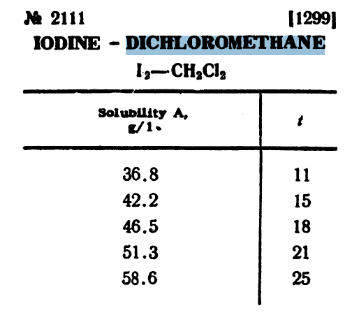

Solubility of iodine in dichloromethane
Does anyone know how soluble iodine is in dichloromethane? I have searched on google etc and found a lot of data for benzene, toluene, carbon tetrachloride etc but not DCM. It is clearly pretty soluble >100g/L but how soluble.

[*] posted on 2-8-2020 at 15:54
Solubilities of Organic and Inorganic Compounds, Volume 1: Binary Systems, Part 1, p 626, 1963.
I2-DCM.PNG - 17kB
draculic acid69

Hmmm....let's see.
The solubility of iodine, according to Eddie Current's source, is 58.6 g/L of dichloromethane. The density of dichloromethane is 1.33 g/mL, so that works out to be 4.4 g I2 per 100 g DCM.
Let's compare this to some other solvents, which we can find on chemister.ru (http://chemister.ru/Database/properties-en.php?dbid=1&id... ) All values in g I2 per 100 g solvent.

So iodine is MORE soluble in dichloromethane than chloroform or carbon tetrachloride (despite my attempted explanation about stronger London forces in the latter). it's not a simple relationship with polarity, or carbon disulphide and benzene (absolutely nonpolar) and ethanol (very polar for organic solvents) would not both be better solvents than dichloromethane. It's also not purely London forces, or bromoform wouldn't be such a poor solvent for it.
Or maybe the numbers would show a more obvious trend if we did the math to convert them all to mole fractions?
