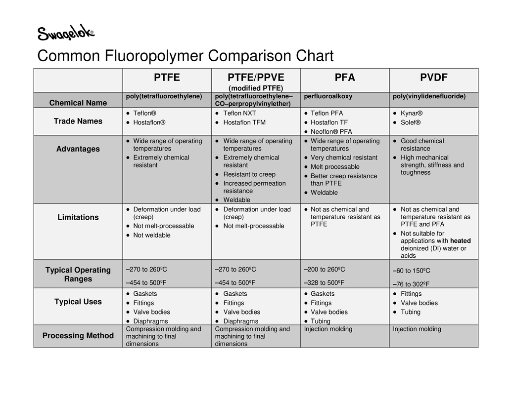

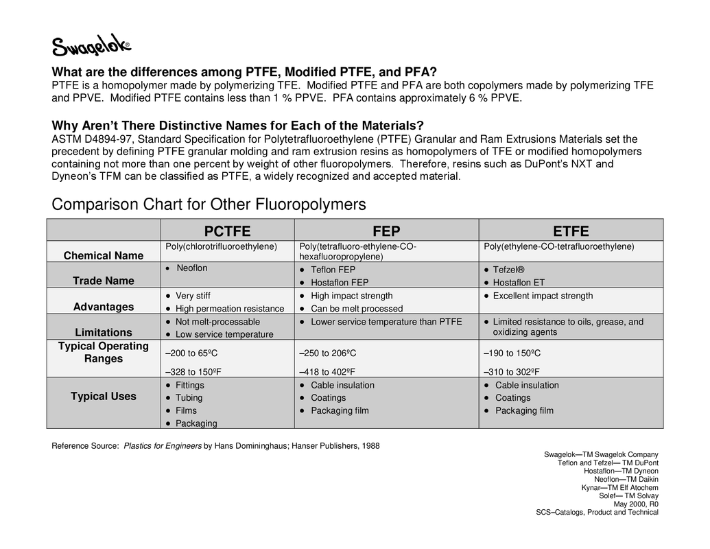

Chart Comparing Various Fluoropolymers
Ran across this earlier thought some other people may find it informational...
[Edited on 22-8-2020 by thermochromic]
