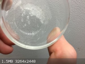

UPDATE: results
Starting amount: 112g of fleshy moist sassafras rootbark
Yield of sassafras oil: 2.2g
% yield: 1.96%
Commentary:
The yield is only about 2% before drying. Pretty shabby, but thats the way it is. The oil from this batch was much more viscous than my last batch. It was closer in consistency to olive oil or vegetable oil than the sassafras oil i know and love.
You can see in one of the photos i attach, the is clumps of oily solid. That’s what it looks like when drying micro quantities of oil, its just painful to look at all the oil left behind and lost. You could just make the whole thing an acetone solution, but thats no fun. This oil loss is why its more efficient to save up a lot of undried oil and then dry it all together. You’ll lose a lot if you dont. Then again, drying is optional but preferred.
If you oil is cloudy like mine in the other photo, then you got some magnesium sulfate still in there from the drying step. Vacuum filtration would probably be best to remove this.
Now my whole lab smells like sassafras :D

Why not extract with ether, dry the ethereal solution, then decant and evaporate? You’ll lose a lot less oil that way since whatever liquid is left stuck to the drying agent will be some % of oil in ether instead of 100% oil.
And to reiterate my earlier question since it was not answered, did you try extracting the hydrosol to recover more oil? I’m curious to see how much this would increase your yield.
No, i have not tried any ways to recover any oil from the hydrosol that may be lost. To me, it is not worth the effort for such a small amount of oil gained in return. I would be glad to send you some sassafras hydrosol if you are willing to experiment with it and post the results yourself, though.
As for the drying step; it wont hurt your yield much as long as you’re drying >10ml quantities of oil. I measured the oils weight before drying, so actually the yield i measured is theoretically too high, but only by 10’s of milligrams.
