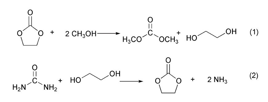

I also made the mistake of attempting to capture the ammonia because why not... this would have been fine but I didn't have the capability of stirring the ammonia trap and a thin layer of over-concentrated ammonia blocked absorption from the bulk as it floats. Swirling helps but it wouldn't be my first choice.
Also my other post could have been a bit clearer but two reaction steps is a good trade off for avoiding war-gas as was the intent of OP. Overall scheme:

Swinfi2 The first reaction in that paper sounds reproducible (EG and urea to EC), but i'm unsure about the second (EC and, in my case ethanol, to DEC) as it's run in an autoclave at 150C for 4 hours; i'm not sure simply refluxing would be sufficient, what do you reckon?
https://www.sciencedirect.com/science/article/pii/S156673671...
This paper mentions alkaline earth metal oxides can be used as catalysts, so maybe i'll distill off EC and try the reaction refluxing with CaO and ethanol.
Swinfi2
Posts: 129
Registered: 19-2-2018
Location: England
Mood: Catalytic
[*] posted on 13-11-2020 at 09:13
I'm not 100% sure with Diethyl carbonate, however most transesterification reactions are an equilibrium so you would want plenty of ethanol and minimal water.
Im guessing they use heat and pressure to avoid contamination on their analysis but a more typical catalyst is acid or base with reflux. In this case the acid part of the di-ester is CO2 so I think you would probably do better with base over acid as acid may promote decomposition. Also DEC/DMC/EG are common battery electrolytes so should tolerate alkaline conditions.
Can't guarantee it will work but I would try:
1eq EG + 10eq EtOH + 0.1eq NaOH -(reflux)-> Products
NaOEt may work better as the catalyst if you can get/make it but I hear that can be tricky.
As for the paper, CaO seems like a good option as it would destroy water, but heterogeneous catalysts suffer poor contact area. On the other hand it would make the workup easier as you can just filter it.
