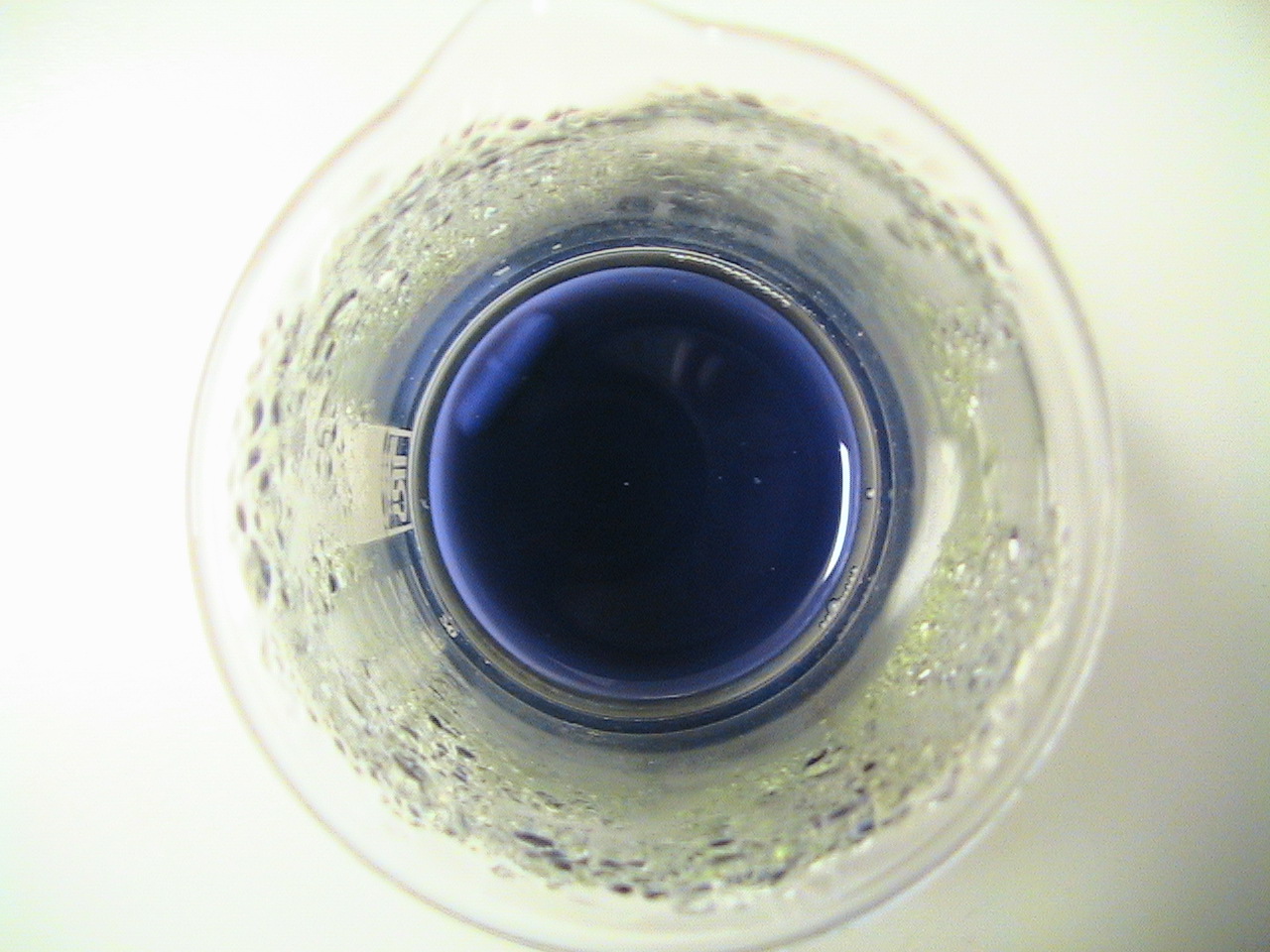

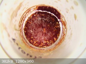

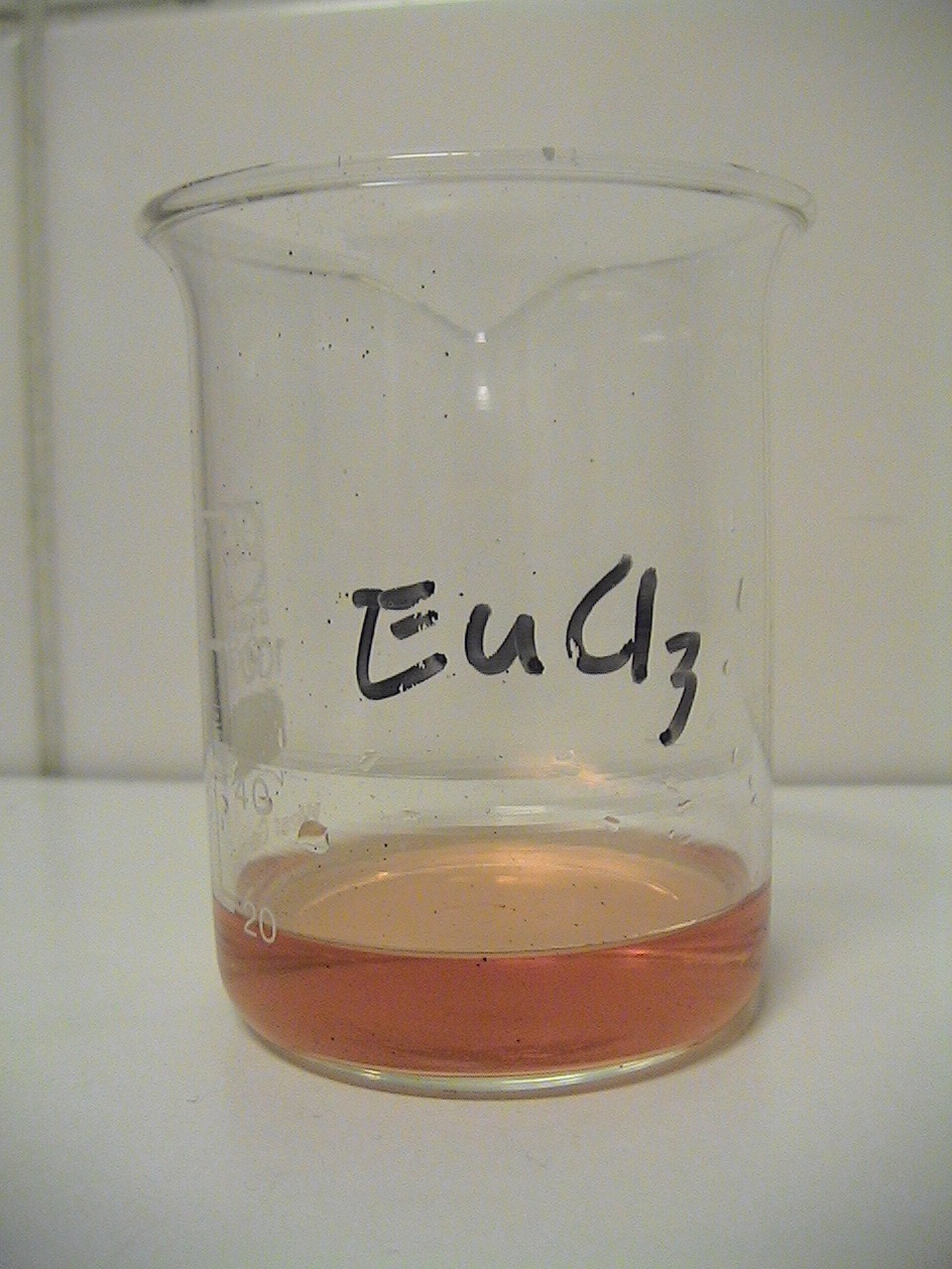

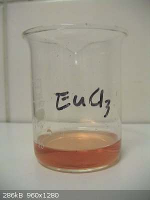

I received some violuric acid from RustyShackleford yesterday in order to test what colours its rare earth salts have - thanks!. It's already after midnight now, but I could not resists the temptation to do one test.
Violuric acid is sparingly soluble in cold water, but much better in hot water. I noticed a somewhat sweetish smell coming off the warm solution (~60C).
0.291g of violuric acid was dissolved in ~15ml warm water, giving a clear purple solution (the dry salt is off white). This was added to a solution of 0.229g EuCl3.6H2O in a few ml water, yielding an orange solution!
IMG_3529_adj.jpg - 286kB
The solution is evaporating in a desiccator over NaOH. I'm charging up my UV lamp batteries to see whether the solution still fluoresces. EuCl3 solution (as well as the solid compound) fluoresces with a reddish colour.

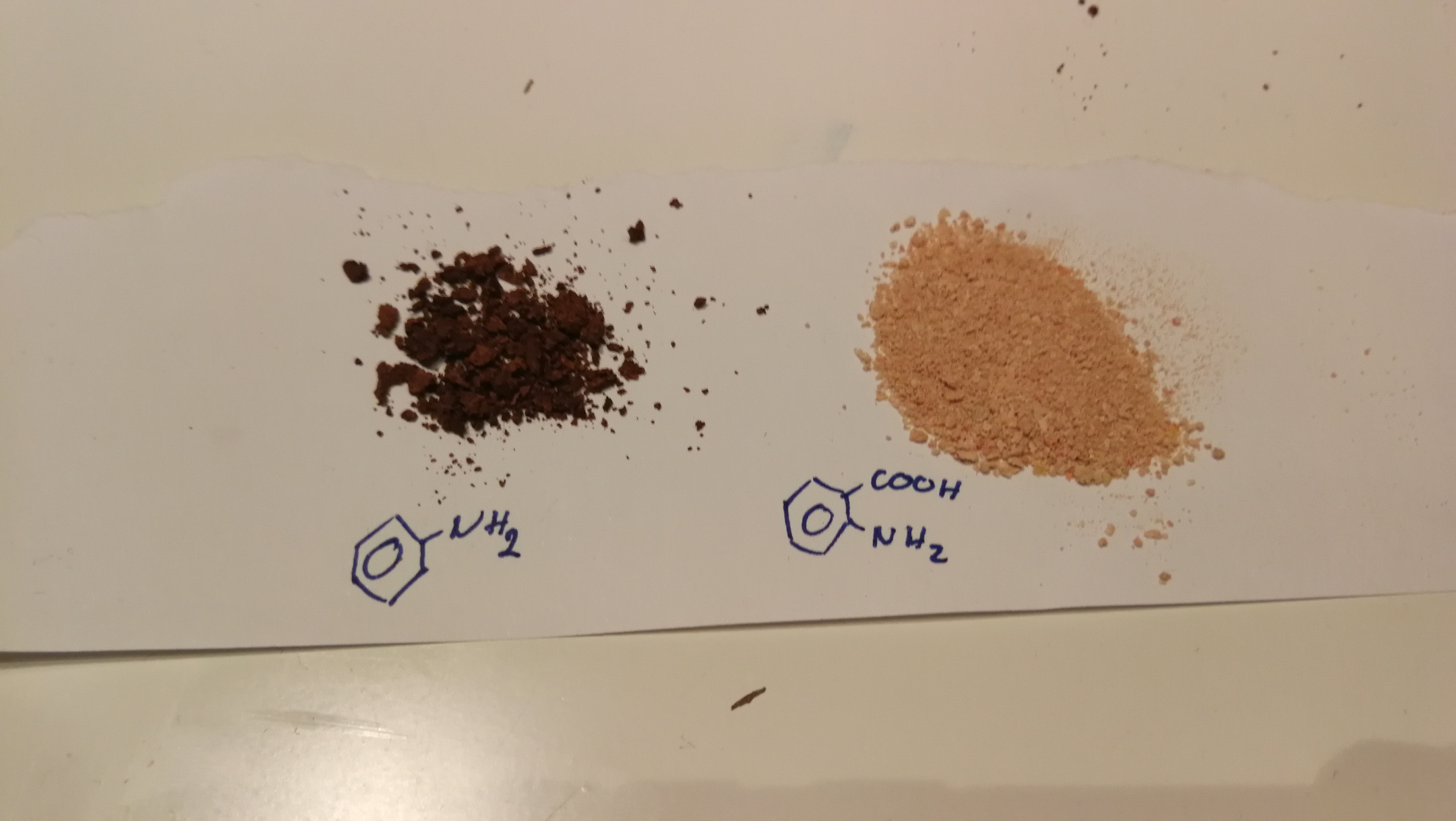

Remade the aniline violurate with distilled clean amine, its a very dark red.
Anthranilic acid violurate is a light orange.
Im planning to make some substituted anilines and try with those (N- acetyl, N-benzyl, N-benzylglycine)

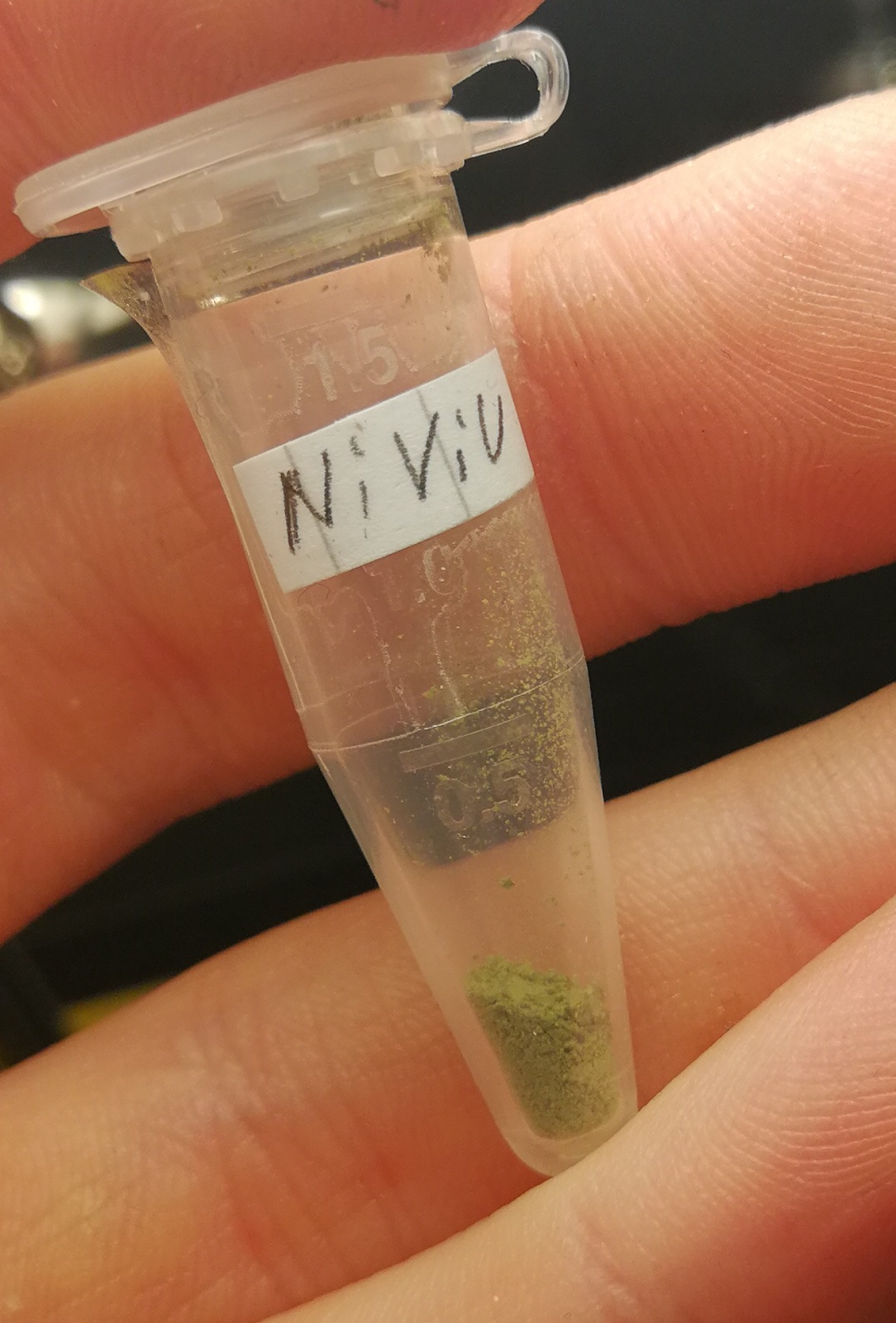

Side note: i have noticed that the color of the salts seem to "develop" over time. Like for example the Ni salt i made is now a more consistent and nicer shade of green than it was when i initially made it. No good idea of what the cause is.
IMG_20210307_191532.jpg - 363kB

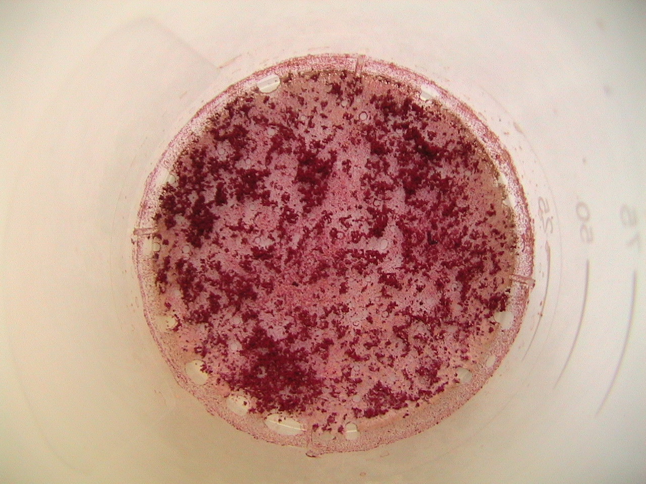

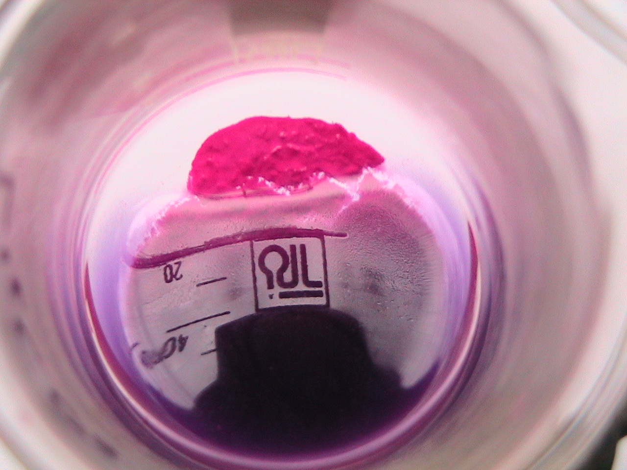

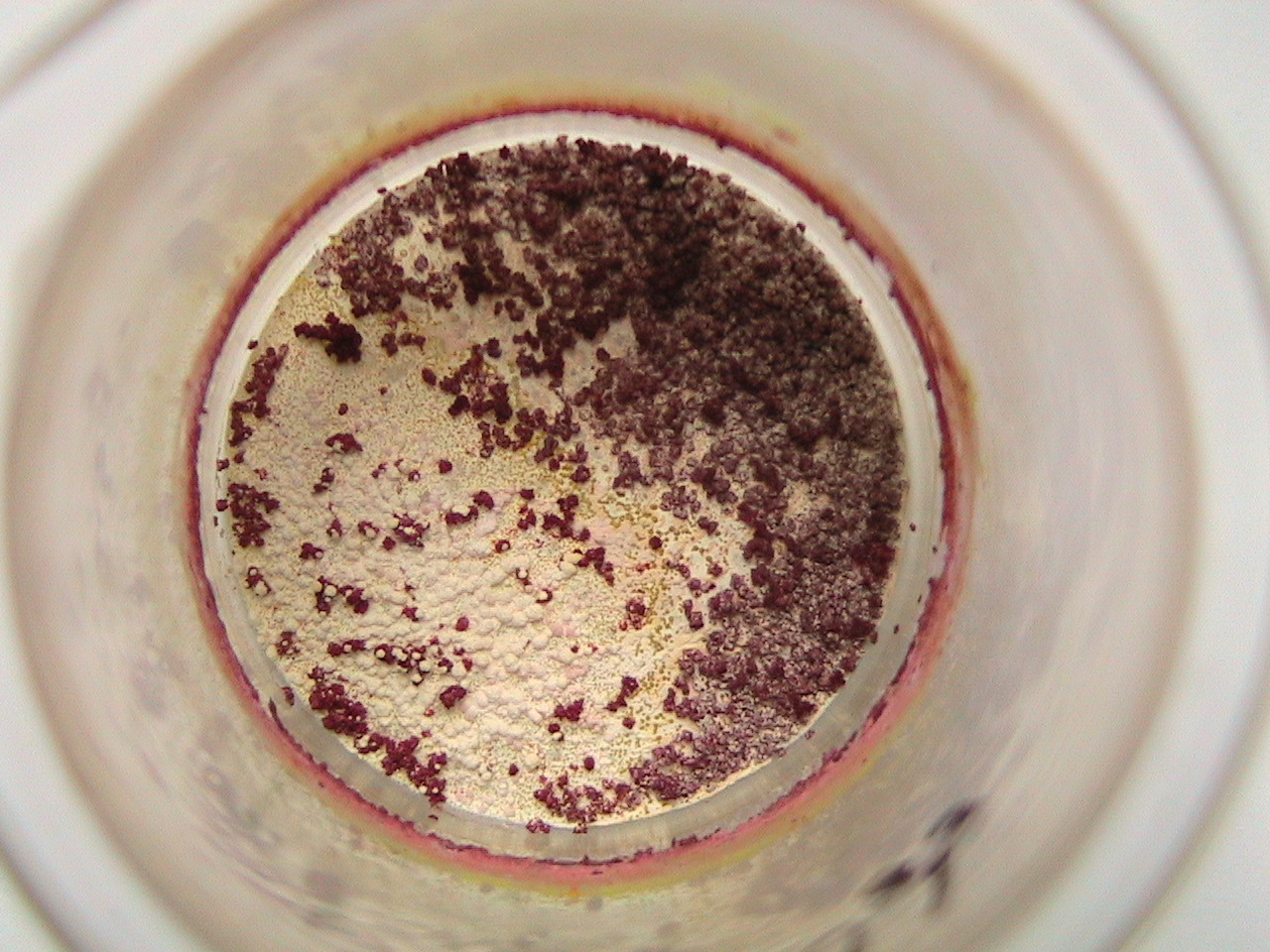

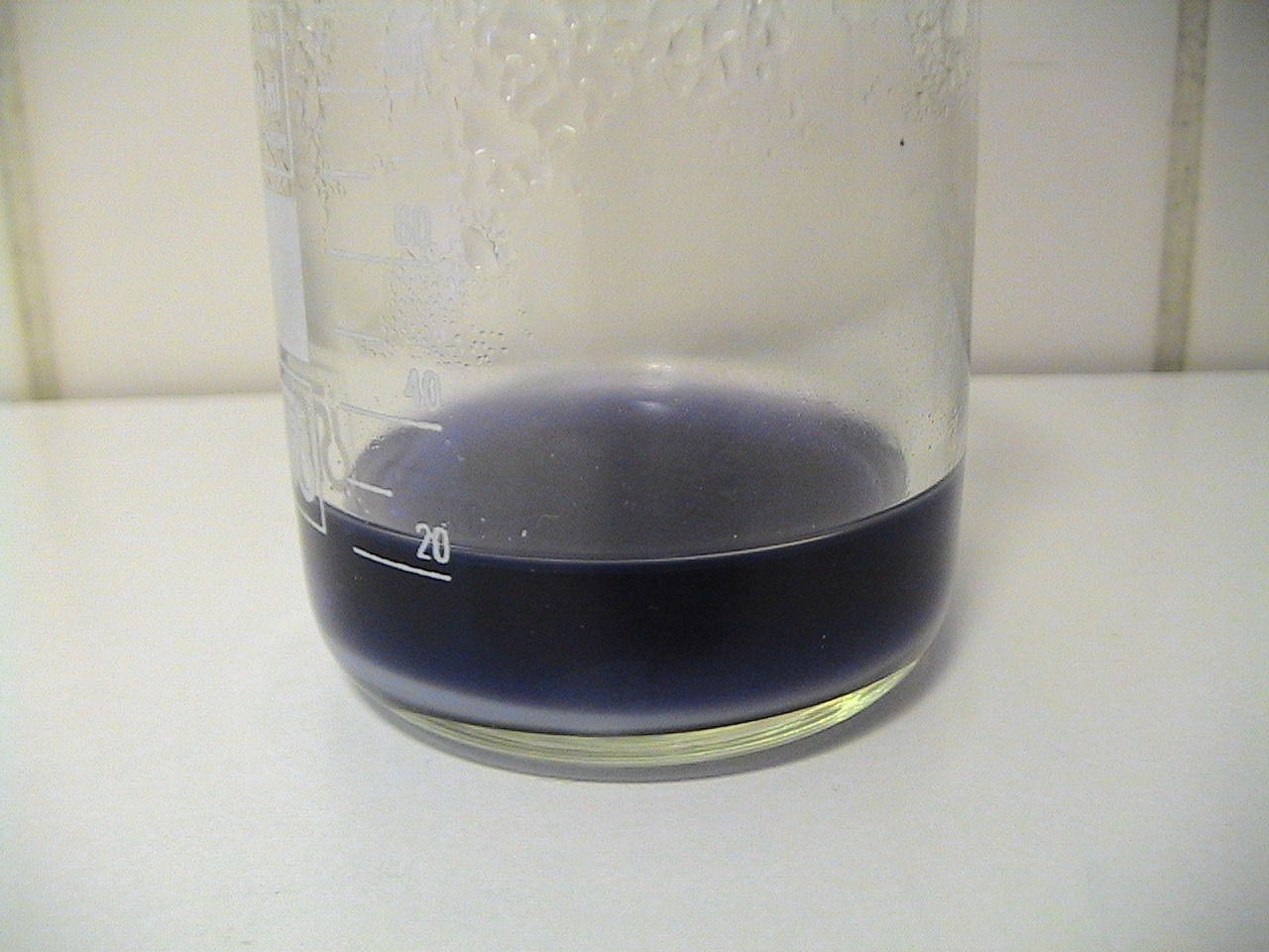

Adding violuric acid to solutions of rare earth chlorides proved not a good idea. I had hoped to evaporate the HCl in solution over NaOH in a desiccator and obtain the rare earth violurates, but this did not happen. Instead, the Eu-violurate shown in my 7 March post lost its colour and a creme coloured solid was obtained.
So I continued to combine carbonates and hydroxides with violuric acid instead of chlorides. Sm2(CO3)3 gave a deep red solution which on drying gave red-brown granular crystals. I assumed the carbonate to be a 2.5 hydrate as posted here (bottom of page 8), but seeing I have some Sm-carbonate coloured residue, my carbonate may just have been dry.
Pr(OH)3 also gave a deep red solution. Pr(OH)3 was added in excess and intensely stirred for 15 minutes on a 70C hotplate. The solution was then filtered using a fine fritte. It's is now drying in a desiccator over NaOH.
Li2CO3 gave a strongly permanganate coloured solution, which on drying gives an intense almost fluorescent pink solid.
IMG_3562.JPG - 414kB IMG_3578.JPG - 329kB IMG_3555.JPG - 332kB

Wow that lithium salt looks amazing!
I have also noticed that its not really possible to make the violurate from strong acid salts of the metal, unless the metal violurate is quite insoluble. The technique i have been using for almost all of the salts i made is to make the carbonate or hydroxide of the metal, adding water + stoiciometric violuric acid, and evaporating that with the hotplate on 120C in a 50ml beaker. For ~0.2g violuric + corresponding metal carbonate/hydroxide ive been using 10-15ml of water. If you get a crummy looking product i have found that washing the salt w some acetone helps.

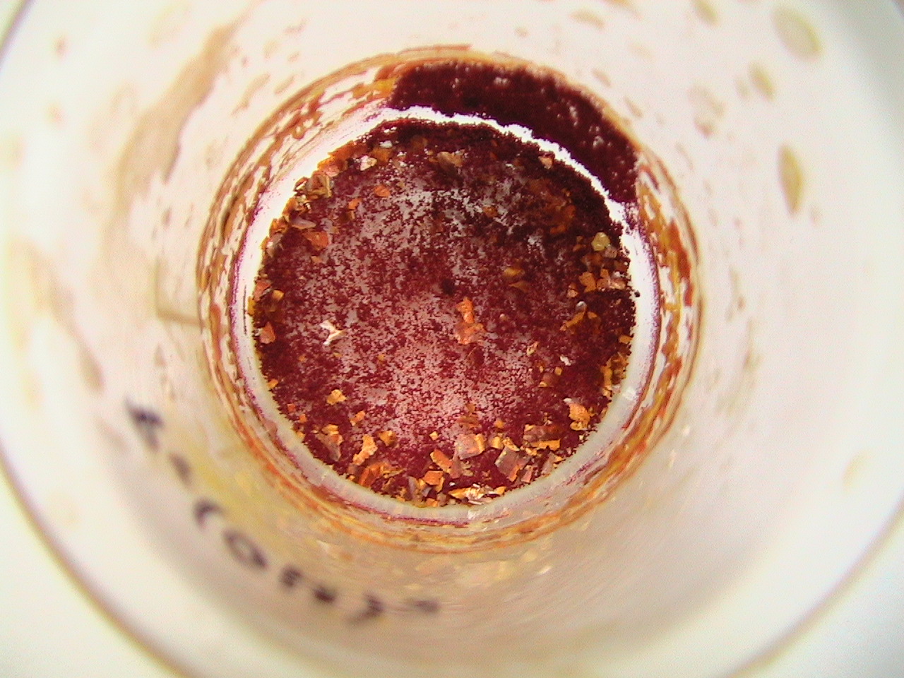

[*] posted on 16-3-2021 at 11:27
Updates
Samarium

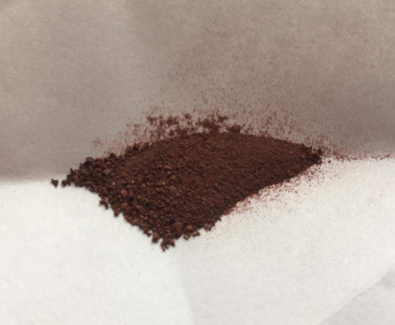

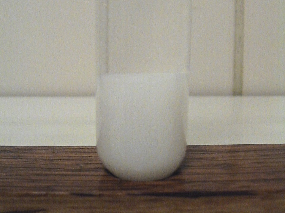

I redissolved the Sm violurate and filtered off the undissolved carbonate, obtaining a warm clear solution. As it cooled down, a beige film formed on the flask. The solution was poured off and dried in a desiccator over NaOH, forming a deep red solid.
IMG_3616.JPG - 324kB IMG_3629.JPG - 420kB

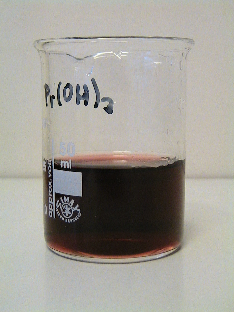

Praseodymium

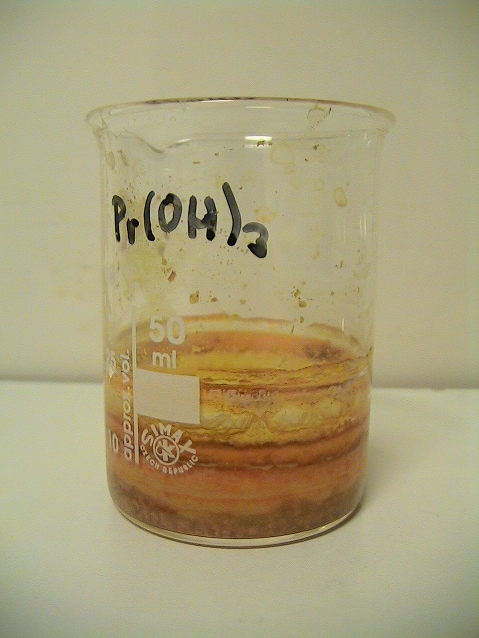

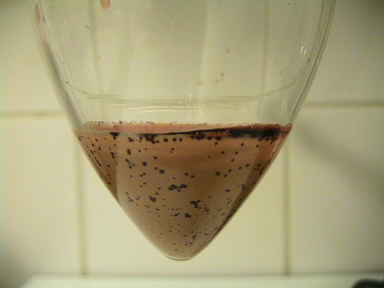

A new sample was made using Pr(OH)3. The hydroxide was stirred powerfully with demiwater, filtered again and then used. 0.300g of violuric acid was added to an excess of Pr(OH)3 and the undissolved hydroxide filtered off. When left to crystallise over NaOH, an orange-yellow film formed on the walls of the beaker and after everything had dried up completely, a mix of dark red and yellow-orange crystals had formed. As far as possible, the dark crystals were separated and the rest was redissolved - the yellow crystals did not dissolve on heating, but the red ones did. The solution is now crystallising again.
IMG_3608.JPG - 354kB IMG_3631.JPG - 382kB IMG_3646.JPG - 366kB
A comparison between the Sm and Pr salts is in the last picture. It looks like the colour of the compounds is mainly caused by interactions inside the violuric acid ligand and not so much by the metal-ligand interactions. In particular the weak green of the Pr forbidden transitions seems to be retained, and causes a minor difference in colour of the salt as compared to Sm.
IMG_3643_adj2.JPG - 312kB

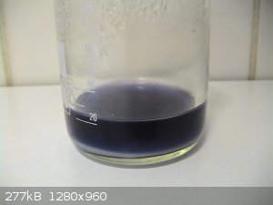

0.096g of indium were dissolved in 10% HCl. This took a long time, although the acid was heated to near boiling. The indium was precipitated with ammonia solution and the supernatant liquid pipetted off 3 times. 300mg of violuric acid were added. The solution turned purple immediately, which suggests that not all of the ammonium had been removed, although the pH of the solution with the In(OH)3 was 8.
On heating hardly any of the precipitate dissolved. The beaker was covered with cling film and put on a stirrer at 1200 rpm and heated at 70C plate temperature and stirred for 1 hour. Still much In(OH)3 remained undissolved, but the mix had obtained a colour resembling molybdenum blue.
IMG_3603_adj_detail.JPG - 163kB IMG_3623.JPG - 283kB IMG_3626_adj.JPG - 277kB
It seems that indium is chemically too basic to easily form a salt with violuric acid. My estimate is that this will count all the more for Re, Mo and W. I decided that I will not make the uranyl salt, because of the precautions necessary to safely work with it. I consider cerium, which is interesting because it is a coloured RE and also has a stable +IV oxidation state, and aluminium.

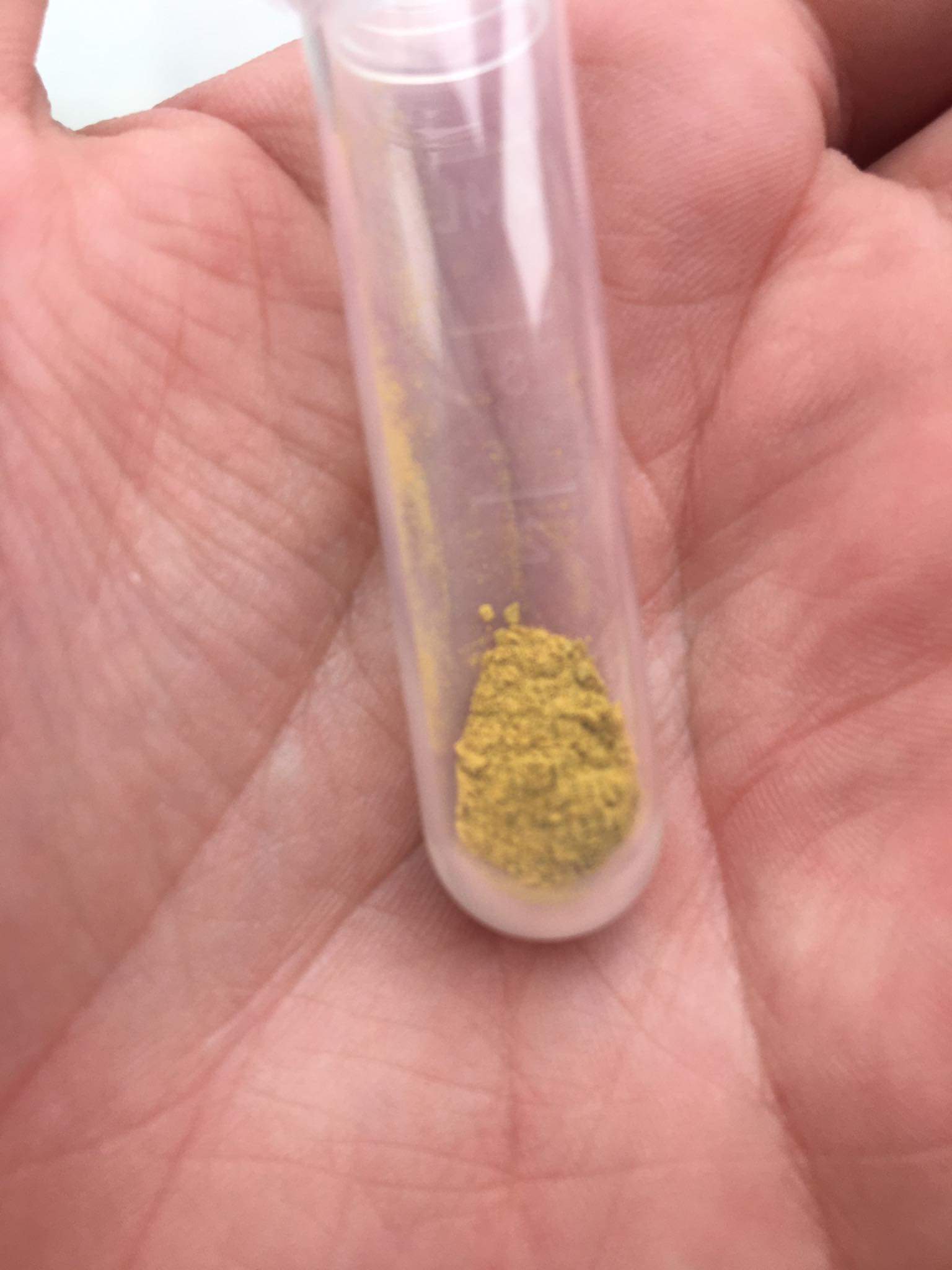

[*] posted on 27-3-2021 at 03:55

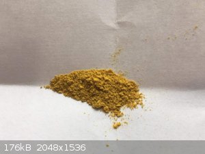

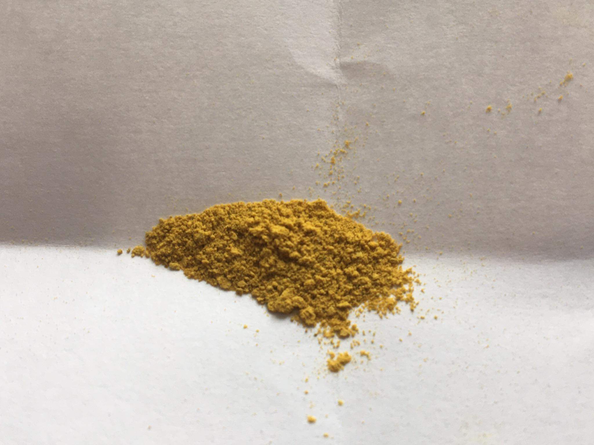

Hi. RustyShackleford gave me violuric acid and will make some violurates. Today i made scandium violurate, i used scandium carbonate. Nice yellow- brown colour.
received_912623242885571.jpeg - 176kB
received_247565420429893.jpeg - 123kB
RustyShackleford
Posts: 192
Registered: 10-12-2020
Location: Northern Europe
[*] posted on 27-3-2021 at 04:40
Very nice! Thats the first yellow violurate salt i believe
