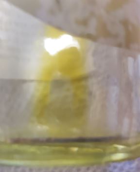

[*] posted on 14-1-2021 at 10:18
Attempt 2 update
I redid the reaction using 100mL of acetone and 100mL 33% HCl and left it overnight at 50C. After stirring stopped many oil drops formed on the surface of the solution. I have added an additional 30mL of acetone to try and convert more mesityl oxide to phorone. We will see how that goes in a few hours

EverythingAl2O3
Posts: 51
Registered: 3-9-2019
[*] posted on 14-1-2021 at 14:30
Phorone update 2 product after acetone addition
So...This did not go anything like it did previously. I added an additional 30mL of acetone after reacting overnight, and left if for 5 hours. Upon neutralization instead of getting a thin yellow oil layer developing and all the red coloration disappearing, I have been greeted with this deep band of dark red oil on top of the water layer (with some phorone dissolved in) which probably only separated because NaCl salted it out. So not sure how much mesityl oxide is in this layer or if this is pure phorone which since it is more concentrated has altered appearances. I guess simple distillation or recrystallization will determine that? What I do know is that all the acetone has been consumed because at 75C no boiling began unlike my first run.
