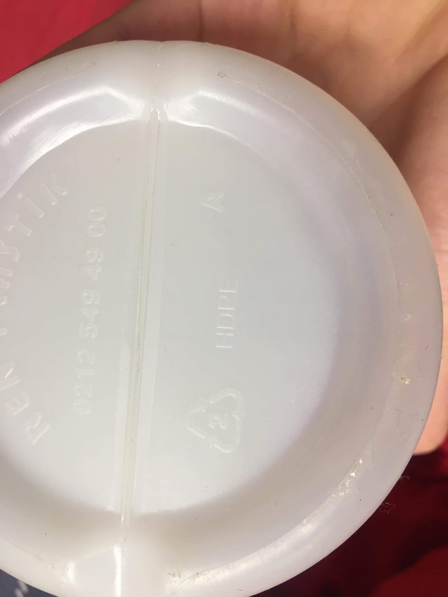

[*] posted on 10-2-2021 at 12:54
98% sulfuric acid, which I buy is poured into HDPE bottles.
This is a phosphoric acid, but sulfuric acid is in same 1L bottle.
received_1569655646559586.jpeg - 156kB received_2818146455100867.jpeg - 74kB

[*] posted on 10-2-2021 at 23:34
They store sulfuric acid almost exclusively in HDPE canisters. I've always got mine in them, even the brand reagent grade ones. Never seen a glass bottle for it. Plastic, when allowed, is superior to glass in every way as a storage media.
If picking a new container, just make sure it is unadulterated HDPE, as many commercial plastics contain filler like calcium carbonate or other cheap stuff that lowers the bulk price of the plastic without affecting it's structural properties and allow it to be suitable for food packing and other not-too-reactive stuff, but may cause reaction with strong acids.
Sulfuric acid, especially technical grade ones, often comes naturally in slightly yellowish tint. Mine is at 98% pure, and it does not affect anything in any way.
