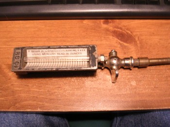

I snapped a few pictures of it. I think its probaley from the 1950s or 1960s. Very Industrial looking
mercury gauge.jpg - 63kB mercury gauge close.jpg - 57kB

It is a mercury or possibly also water gauge, would make sense why it says "when using Hg read ounces". Makes more sense as a pressure gauge for low (below atmospheric) readings. Why is ounces hard to fathom if you are used to pounds? As in pounds per square inch. An ounce would be logically a sixteenth of a pound per square inch. Hard to tell with such a small low resolution pic, would help if you would at least print here every word and graduations on the thing. I am sure we could figure it out if we knew what was written on it and blowing up your pics is useless.

Is that glass tube vented to the atmosphere? If, so perhaps this is the other side of a U-tube that is connected to the brass tube with valve.
I would like to see the numerical markings on the scale. Is there a zero point in the middle of the scale?

Shoot, both my cameras just died. The scale on the gauge reads from 0 at the bottom to 22 at the top. Other than that and the wording I described originally there really isnt much else. There is the inlet with the valve in it on the top and a screw type thing right infront of that, this connects directly to the glass tube with the mercury in it. Ive searched Meriam's website, but all their stuff is digital. I really want to find a way to use this gauge in my lab as its cool looking and has an industrial theme to It I would like to try to incorporate into my lab.

Well, it clearly says it is a pressure gage. But "ounces of mercury" is a strange unit and I've never seen it before.
Perhaps the bottom serves as a storage pool for the mercury. Can you fill it with water through the brass tube? Or, can you blow air through the brass tube and out the glass tube?

Wow, I feel really stupid now. I never thought to apply pressure to the thing to see what would happen.... anyways, I did and the mercury level rose significantly. I haven't tried any type of fluid yet.

You are making progress. It seems it is a pressure gage with a mercury pool in the bottom then. I wouldn't put any fluid in it but air or a gas that doesn't react with mercury. Otherwise the mercury may become contaminated. (I was surprised it still contained mercury.)
If you can measure the length between the gradations on the scale you can make a cheat sheet that would convert these spacings to something more useful like mmHg or inches of Hg.
When it is stood up vertically does the mercury rise to the zero mark? If not you may have to add some Hg to make the gage useful.
[Edited on 9-3-2011 by Magpie]
Is the scale (from 0 to 22 oz.) 3" in length? If so, here's an interesting calculation that may apply:
3"Hg = 0.10 atm = 1.47psi = 23.5 oz/in^2
23.5 is numerically close to the range on the scale. So as IrC indicated, the unit "ounces" may indeed be slang for ounces/in^2.
