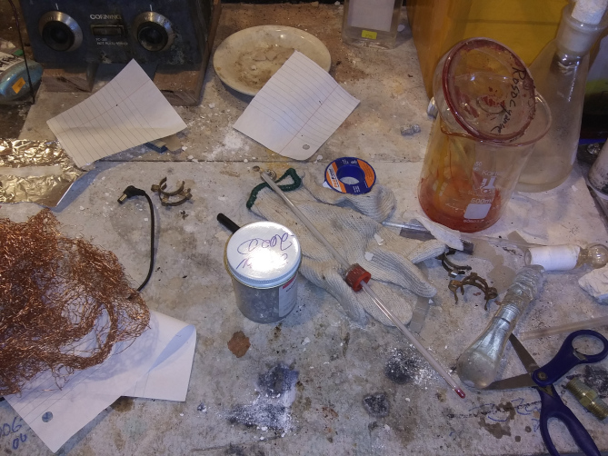

This piece of concrete wall board in my rather fucked off work area is extremely useful. Fireproof, and fairly chemically resistant/self neutralizing.
