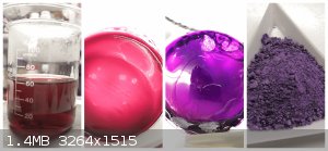

I made a bunch of sulfamates in the past. The Ni salt is extremely hygroscopic and you will get a viscous oil that takes a lot to dry. The Co salt gives a very hard crust. The Mn(II) salt is a dirty white solid.
nickel solfammato-min (1).png - 1.4MB
cobalto solfammato-min (1).png - 1.4MB

[*] posted on 23-3-2021 at 01:06
Thanks for sharing your experience. Did you ever tried chromium salt?
