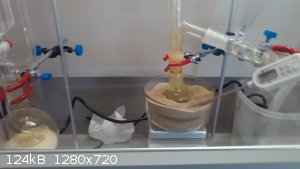

What kind of gas mask should I buy for chlorine/SCl2
I'm looking for a gas mask that I can use against chlorine and NO2. I use solvents, but I have a hood so that isn't a problem. When I do SCl2/Cl2 experiments in the hood, the smell still gets out. Also, dealing with stuff like SCl2 outside of the hood, like for bottling or small reactions, is a pain. I'm writing this post in the garage next to my hood in which the reaction is happening. No smell yet, but I'm sure that'll change within the hour. Getting back to the point, what kind of gas mask should I get? I don't want to go for a surplus military gas mask.

There are too many variables to give a specific recommendation. The respirator by itself should be full face and resistant to acid fumes (industry term for corrosive gasses e.g. Cl2, HCl, HF, SO3/SO2). The cartridge will also have to be rated specifically for chemical use, again for acid fumes. A cartridge meant for blocking particulate is NOT adequate. I have some experience with 3M products so I personally would go in that direction. If 3M works for you, an olive cartridge looks most suitable for your purposes.
This equipment doesn't come cheap though. Before making that investment try modifying your existing setup (seal joints, seal the outlet of your hood, shrink the inlet area to increase the velocity of incoming air).

Well moreover the problem with my hood is the sash height. Its a window sitting on pegs, so there really aren't that many height settings. Also, Cl2 and SCl2 have really low odor thresholds.

In most acute case you can increase flow by just wrapping some plastic wrap in critical places. The smaller the gap, the bigger the flow ratio - presuming the extraction is efficient.
