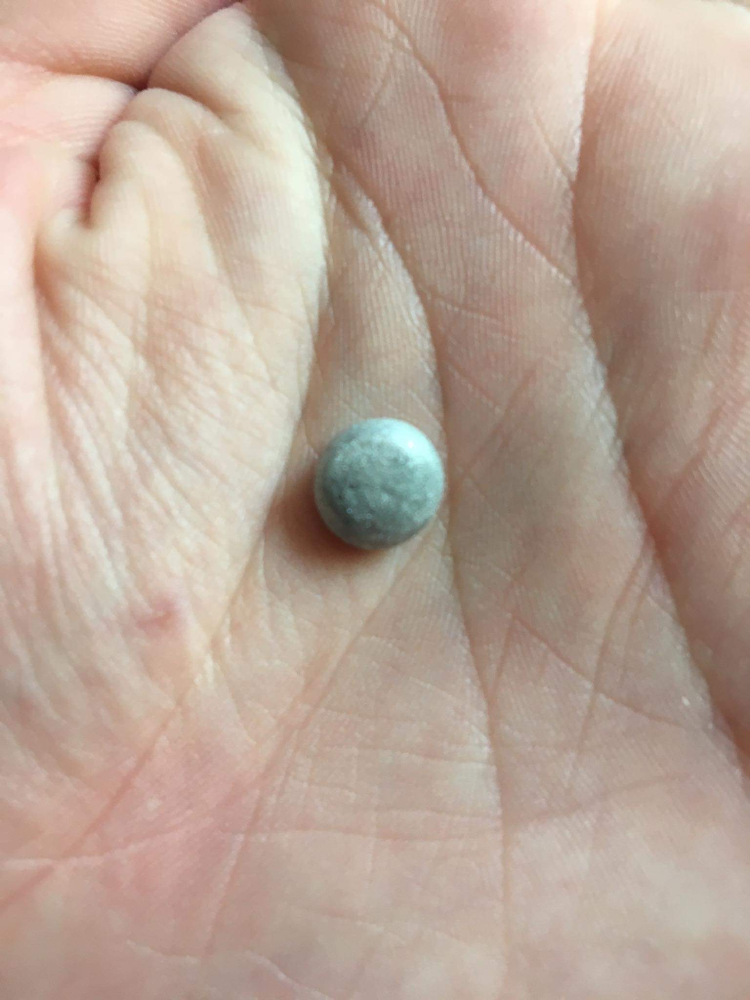

What is this metal?
Hi today i found chemical jar, full of this metal pieces, label was lost. I don't know exactly what it is. First it is hard and have low melting point, but it isn't tin or lead(its hard), also not zinc because it didn't dissolved in conc. HCl and dillute H2SO4. Not cadmium because when i melted this granules, colored oxide didn't produce. I think its pure metal, I've seen metal alloys in lab, but always they are powders.

Posts: 3829
[*] posted on 4-5-2021 at 04:21
Indium ?
samarium14
Posts: 661
Registered: 22-3-2019
Location: Georgia
[*] posted on 4-5-2021 at 04:24
No, i have indium, You can chew it like gum.
After melting:

Posts: 8107
[*] posted on 4-5-2021 at 04:28
Does it dissolve in conc. HNO3?
What if added to a mix of conc. HCl and 30% H2O2?
If it dissolves in one of the above, what color does its solution have?
samarium14
Posts: 661
Location: Georgia
[*] posted on 4-5-2021 at 04:37
Thanks woelen. I thought that, i have azeotropic nitric acid and 50% peroxode but unfortunately in another city. Here i have mentioned acids, conc phosphoric acid (i think it isn't interesting) and hypochlorite 15% solution, i will use hypochlorite. Either way I do, I’m sure it will dissolve in nitric acid
zed
Posts: 2302
Registered: 6-9-2008
[*] posted on 4-5-2021 at 14:13
Flame test.
rockyit98
Posts: 283
Registered: 12-4-2019
Location: The Known Universe
Mood: no mood is a good mood
[*] posted on 4-5-2021 at 14:36
easiest way is to find out density using lab scale and do a comparison . also try and find the melting point if can.

Posts: 3829
[*] posted on 5-5-2021 at 07:15
Flame test.
+1

samarium14
Posts: 661
Location: Georgia
[*] posted on 5-5-2021 at 09:30
I will make flame test, but before that it must be dissolved in acid, at least one week i can't. I will determine the density with water. Thank you everyone for your ideas.

RogueRose
Posts: 1597
Registered: 16-6-2014
[*] posted on 5-5-2021 at 09:40
could it be an alloy like Woods metal or Rose's metal?
samarium14
Posts: 661
Location: Georgia
[*] posted on 5-5-2021 at 10:11
Hmm interesting. It has really low melting point, it instantly melted. I will put it in boiling water. Almost all alloys in lab are powder, but Wood's metal and such metals which have low melting point maybe not. Thanks!

samarium14
Posts: 661
Location: Georgia
[*] posted on 6-5-2021 at 02:53
It's melted in boiling water. I will determine density and that is. Dissolve in acid isn't necessary.
