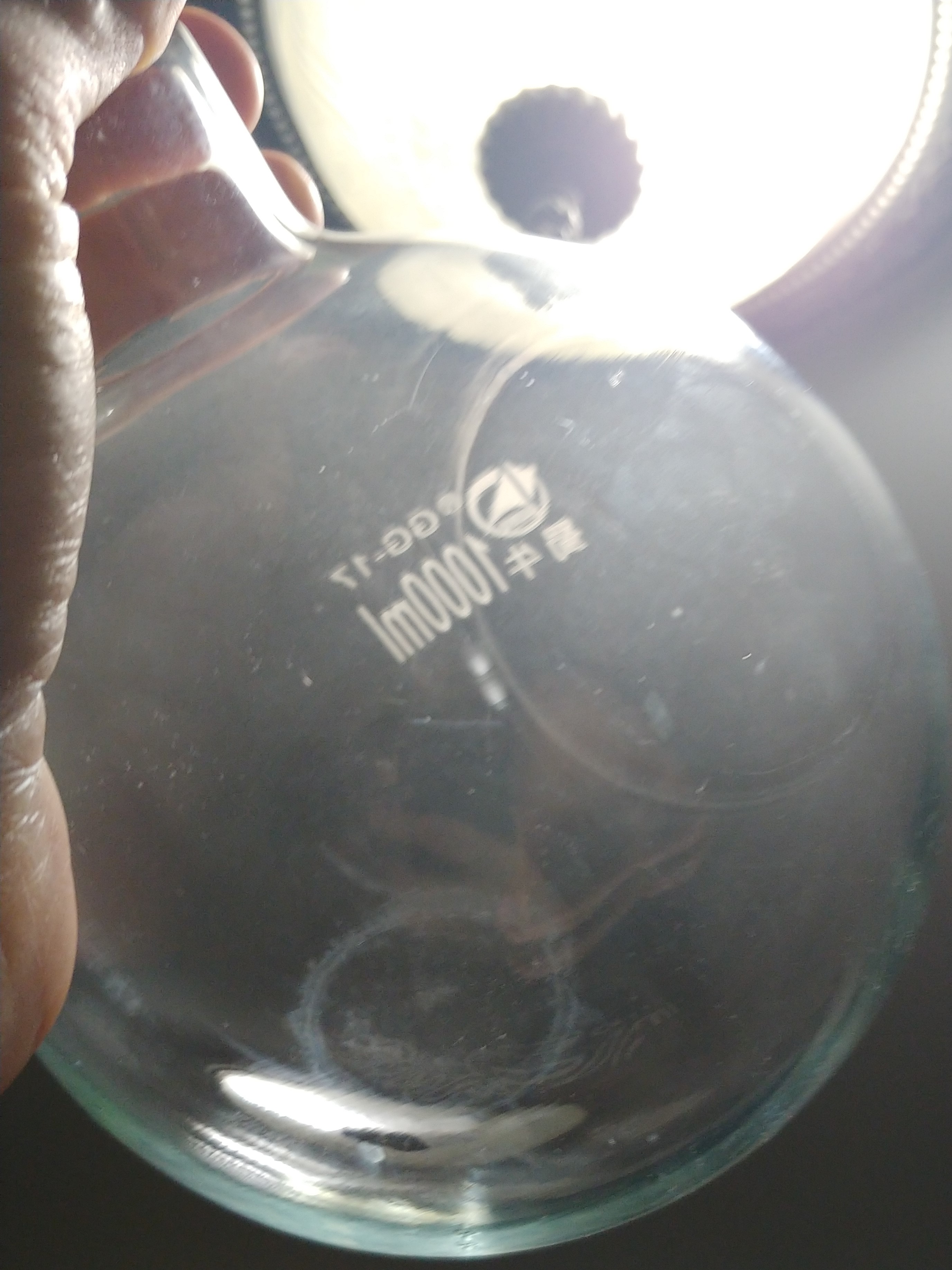

Is my boiling flask OK?
I've recently received the glassware I need and the heating mantel/stirrer for some more advanced distillation and mixing. I cleaned them up and rinsed them with soap and water to get all the glue up and let them dry thoroughly from the inside and out.
But I do see two stains or so on the interior of my boiling flask. I am not sure if they are just water stains or something else. I plan on doing some distillation with sulfuric acid and fuming nitric acid so I need to make absolutely sure my glassware is fine before I do it. I realize how dangerous these chemicals are and the last thing I need is boiling hot acid bursting all over the place (I read the thread of life after detonation and it is terrifying. I have no interest in such a thing happening to me). I attached the photos below. Please tell me if they are fine or I should return it and order another boiling flask.
The brand is GG-17. I got it off Aliexpress. The reason why I chose that glass is because I saw several videos of NileRed using this brand in his sulfuric acid purification video (he did also use a Pyrex boiling flask for one method) and I figure if it is good enough for NileRed, it is good enough for me.
I did some research on this forum about the safety of glassware for distilling dangerous chemicals like sulfuric acid. From what I understand Chinese glassware is thicker than European/American glassware but it is not necessarily better against inorganic compounds.
I plan on making a big safety question dump to get all the safety questions answered before I do any dangerous distillations. My first distillation will be purifying alcohol (as a solvent. I do need some 95% ethanol) which I assume is much safer than sulfuric acid distillation!

[*] posted on 5-5-2021 at 22:59
Sulfuric acid distillation needs heat of way over 400C which can only be reached with few molten salt and metal baths or direct flame, which puts significant strain. I would use sacrificial flask, that is of no tragedy if it happens to crack. Boiling sulfuric acid will eat through everything upon contact, so best not to do it on your best and newest worktable. If I were paranoid and could not do it outdoors or an expendable surface, I would possibly get a sand vat beneath the flask.
But the GG17 and other stuff that deschem and others sell have been good quality so far. All of my glassware, with few exceptions from past times, are theirs. Only few minor imperfections.
Those stains are, if the flask is new, residues from grinding the glass joints. They should vanish with decent cleaning, but as the grinding materials are made of acid-base resistant(mostly) material, it may need mechanical attention to clean.

[*] posted on 5-5-2021 at 23:55
I would use sacrificial flask, that is of no tragedy if it happens to crack. .
Spilling boiling sulphuric acid is a tragedy.
It's easy enough to replace a flask, so that's not going to be the big problem.
Use the best flask you have because it has the least chance of breaking.

Call me an uppity snob or a stuck-up idiot, but I wouldn't risk my equipment and/or my health (boiling sulphuric acid burns) using Chinese glassware. Really. Draw a few more bucks out of your pocket and get prime glassware for that kind of thing.
You probably won’t distill sulphuric acid, as it boils above 330 °C, temperature at which it spontaneously decomposes into sulphur trioxide and water. What I advise you to do is heat your flask up to 200 °C. Hot sulphuric acid will oxidise almost everything it has been mixed with into water and carbon dioxide, so you’ll end up with pure acid. More diluted that you want, maybe, but almost pure. If you want to concentrate it, I'd even recommend generating sulphur trioxide and dissolving it into your acid, rather than trying to distill the latter. Both are dangerous, but at least sulphur trioxide is a gas, and it is visible.

I'm yet to see an issue with Chinese. I've used them for vacuum distillations multiple times. And yes, I've vacced sulfuric acid too, I built a blast shield around the boiler from thick plexi and plywood just in case of implosion. In this matter, I don't have best or worst flasks, they all seem to work equally, the smaller ones only lack the volume of the bigger ones.
For the perspective, distilling sulfuric acid as a first experiment is a bit hardcore IMO, if this is the case.
If you perform distillation outdoors and use gas burner at inert ground, if the glass breaks, the acid just spills on the place, and as long as you and your gas bottle aren't in the vicinity, that's about it. You lose a flask, a gas burner and perhaps a stand and whatever it's on. Chances are small, though, as long as you don't perform any hasty actions, don't heat it at full blast and use air or hot water condenser and a secondary to cool down the condensate. People nitrate sensitive energetics here without a flick, but distilling sulfuric acid is a tragedy?

I successfully used GG17 glass 1000ml rbf and 300mm air condenser (sold as a plain column) to distil sulphuric acid,
during a second run my generic (not GG17) Claisen adapter cracked but the rbf and column seem ok.
If you need but can't purchase conc. sulphuric acid then distillation is the best option
as no choking fumes are released and none of the acid is wasted
you get some dilute and some concentrated distilled acid
and a little concentrated acid left in the pot.
I used the open flame of a butane-powered mini-bbq grill
prepare for violent bumping and the rbf breaking
- consider anything less a bonus.

Thank you very much for your responses and your concerns. I think I am assured that my boiling flask will be OK for this task.
The main thing that I am worried about is the bumping that this will invariably cause. I have boiling chips that should help, and I will only be distilling/boiling very small quantities of sulfuric acid at a time. While I do have a 1 liter flask and I've seen videos where mishaps happen due to overfilling (and those are TERRIFYING) I will not do more than 25% capacity at a time.
I am still thinking whether or not to distill or to just boil it and kill power the instant the white fumes appear. The main thing that concerns me with that is I am afraid my setup might not be able to handle the bumping and it will dislodge my distillation setup. That is my biggest fear. I have a fractional distillation column that will go on top of my flask, then lead to a condenser column (it can have water pumped through it, but for sulfuric acid I was informed this is not a good idea) and numerous clamps to hold everything together. I only have one stand that is part of my mantel. So I will have to improvise by using the bars on my balcony as makeshift stands. The final joint does have vacuum capability, but I don't have a pump to make that work. Despite this, I am still worried about the bumping.
For those who've mentioned that I would need an open flame. I do have a 350 Watt heating mantle that is rated to go as high as 380 degrees Celsius. I don't think I need to put an open flame below it. I don't have the setup for that. But I do believe my mantle will provide sufficient heating power for that.
I have many more questions. I think I should prepare a large question list and dump it all in one go to avoid needlessly making threads.

I was doing a search for something else before I popped by my old thread here. Just decided to give an update.
Seems like the boiling flask I got is a winner! No joke. I purified almost 2 liters of sulfuric with it without a hitch. Adding a good amount of boiling chips controlled the boil that it appeared to boil like water instead of having bumping. My first run I added a few chips and instead of a rolling boil it was steady before giving a rather cool looking eruption. Thankfully my setup for boiling H2SO4 kept me fully protected from all the dangerous fumes.
GG-17 appears to be a good brand at a good price.

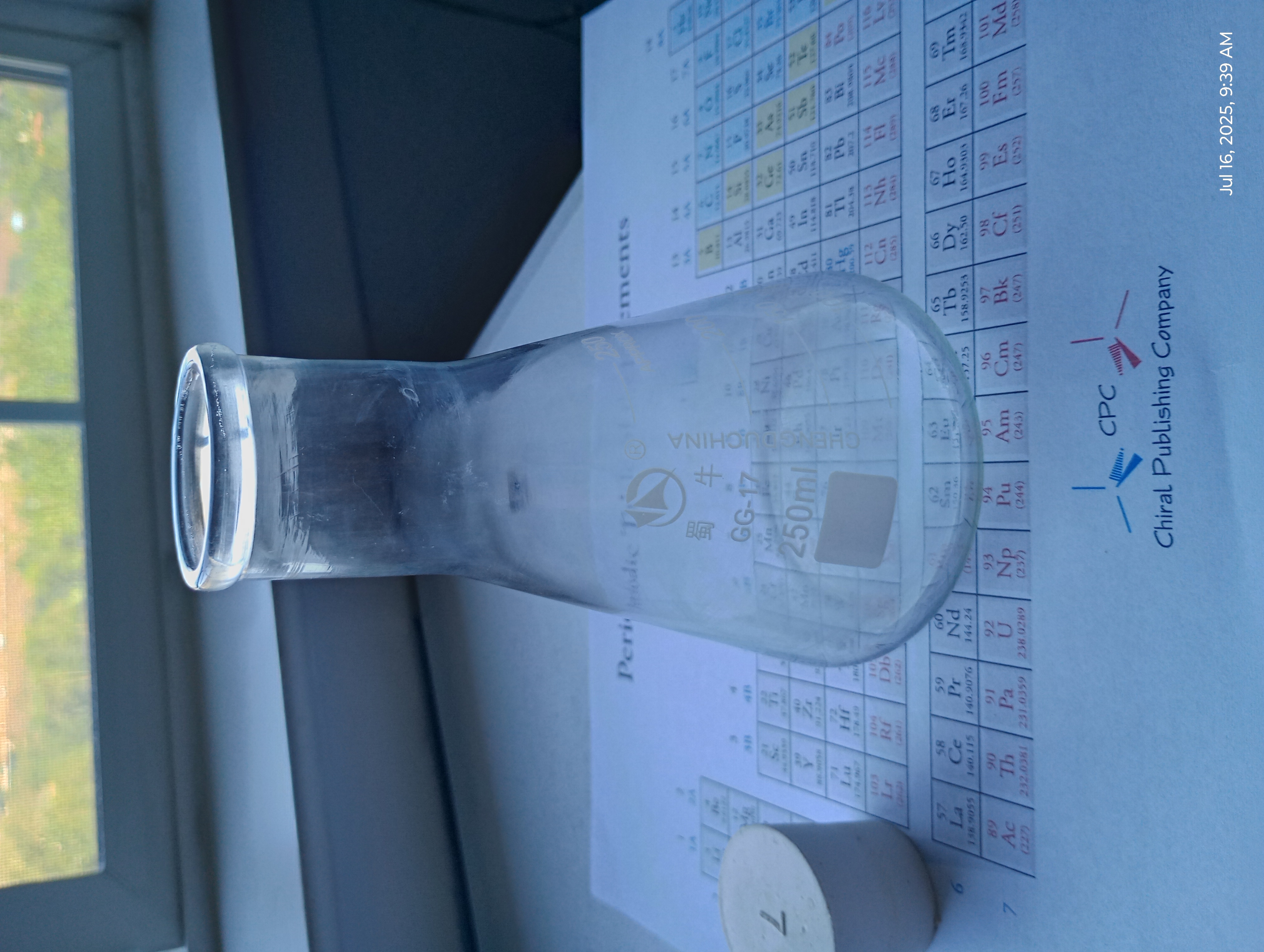

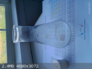

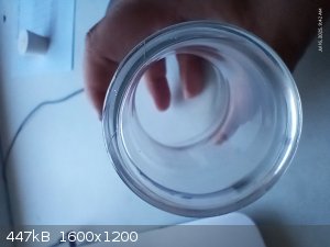

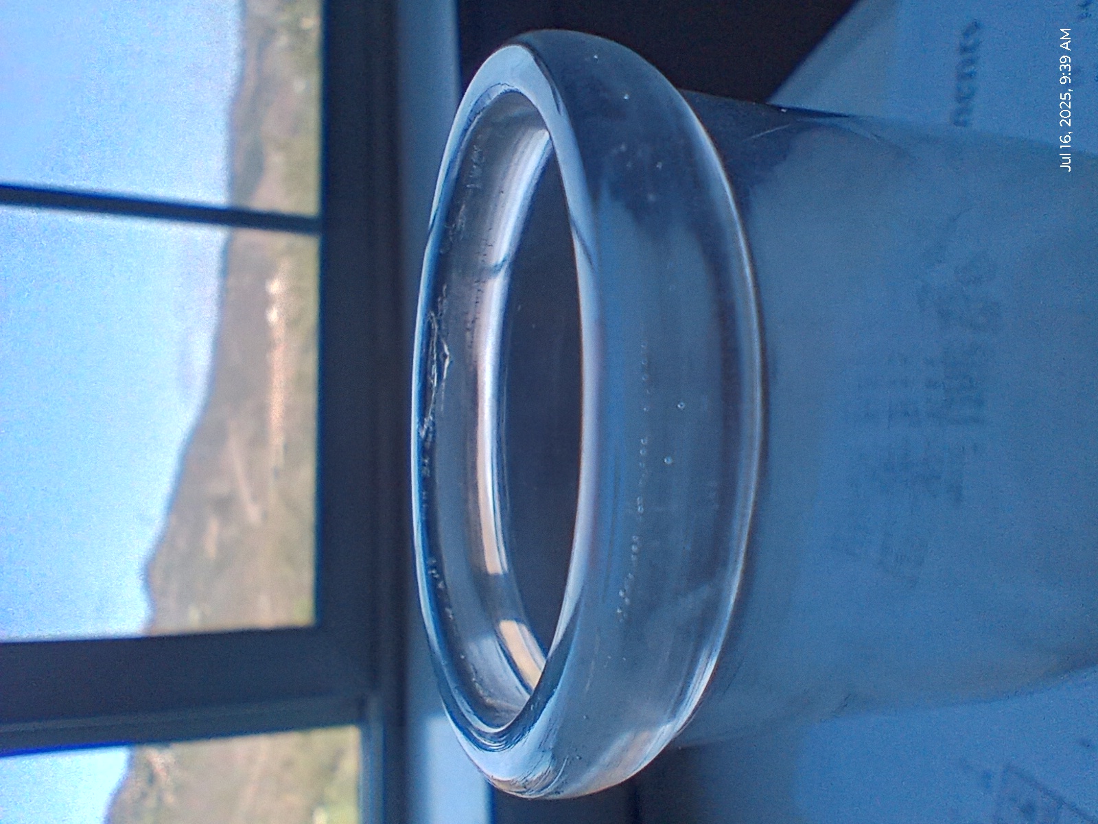

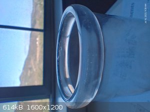

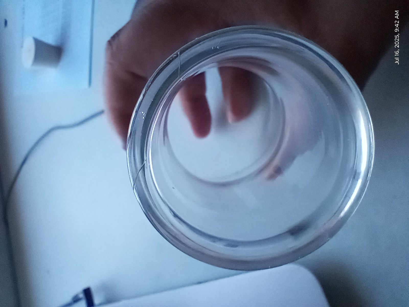

Here is the rim of my 250mL Erlenmeyer
Yay, or nay?
IMG_20250716_093958510_HDR.jpg - 2.4MB IMG_20250716_094223907.jpg - 447kB IMG_20250716_093909523_HDR.jpg - 614kB
Is there anything to look for that is more of a guarantee that there will be less or no imperfections? It says it is GG-17. It is also from China, However, I've had a lot of good, glassware from China Nanshin organic chemistry apparatus, back in the day. Ground glass set, didn't use it really, at all.
I remember looking at the little flasks they have on display at my JC in the bookstore, it did appear that a lot of these flasks did have seemingly minor imperfections, if looked at close enough.
