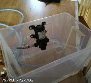

Melkor you are the 5th person ive seen create such a setup and get bad performance. Personally my setup creates only 0.15 bar pressure drop (0.85 absolute pressure). Very very bad, but it still works for vacuum filtering so its not complete garbage.
Ive tried changing around the tubing, but nothing works well. Its a 24V "100Psi 6L/min" chinese pump from ebay.
