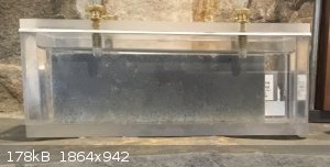

I figured out that keeping it under mineral spirits kept it stable. With much difficulty I isolated the pieces from the atmosphere, and heated them up and let them melt into an oversized 1x2x6 steel mold. With more difficulty I cut away the mold and machined the raw bar to a respectable 1x2x6 bar. All while keeping it drenched in oil to keep it away from the atmosphere.
I now keep it in mineral spirits in an oversized 1x2x6 plexiglass box. It is visually there. And you can take the lid off and handle it for a few minutes, until the spirits start to evaporate off, and you see the white powder starting to form. Then you need to dunk it again.
Anyway, it all sort of works. But not nicely.

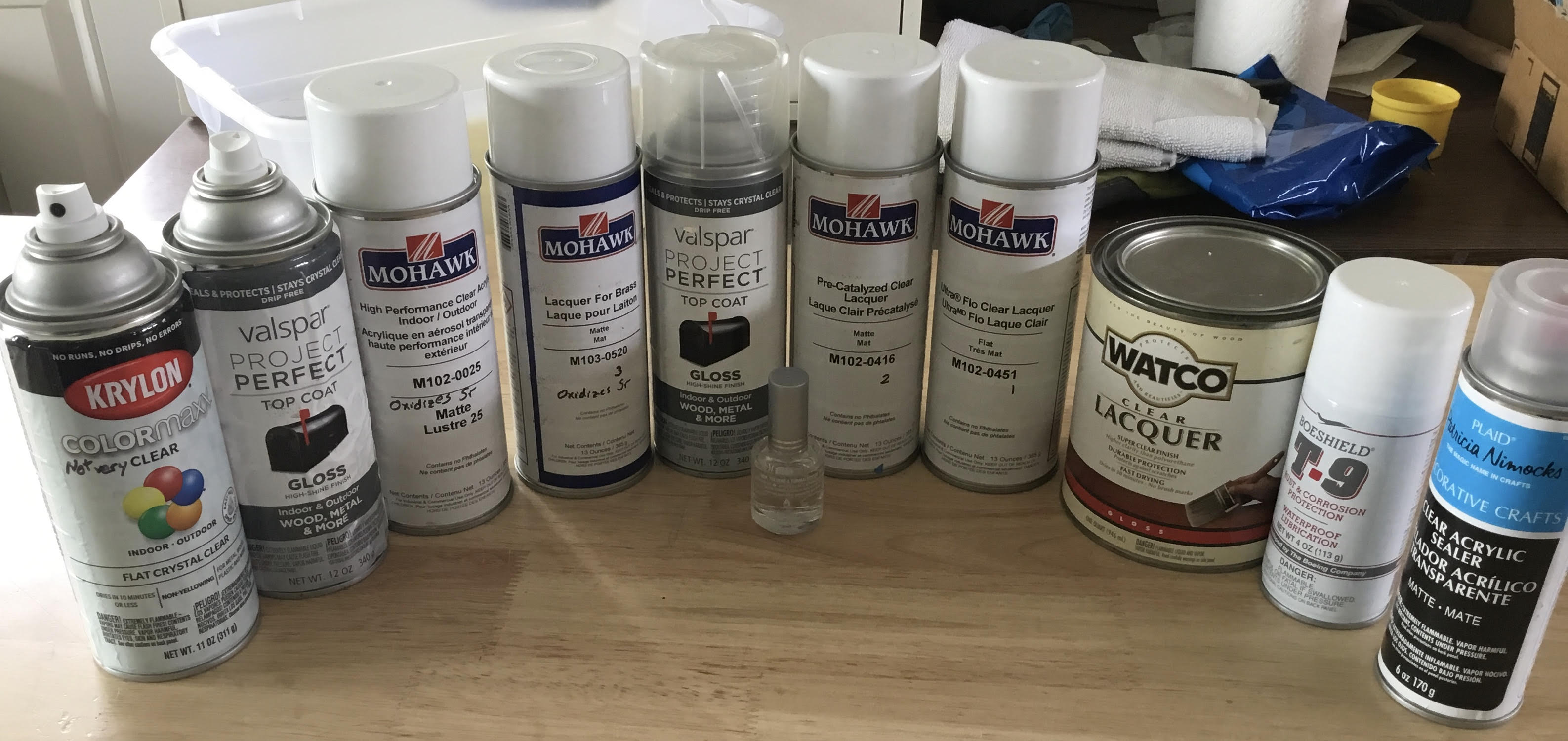

So, finally, to my question. I would like to coat the strontium bar in some similar clear coating. That way I don't have a tub of mineral spirits on the mantel. The coating 1) needs to be clear 2) needs to be air tight 3) cannot react with the strontium.
I have now tried a dozen different coatings. All of them react with the strontium. Including polyurethane and clear epoxy. I have tried several hard waxes (not all that clear) and they react too (or are slightly permeable--I haven't bothered to figure out which.) And every time I see some company selling some new spray coating I buy a can and try to protect a test piece. See snapshots for some of the candidates. None have worked.
So, all you chemists out there, any suggestions for a clear coating that will not react with strontium?
