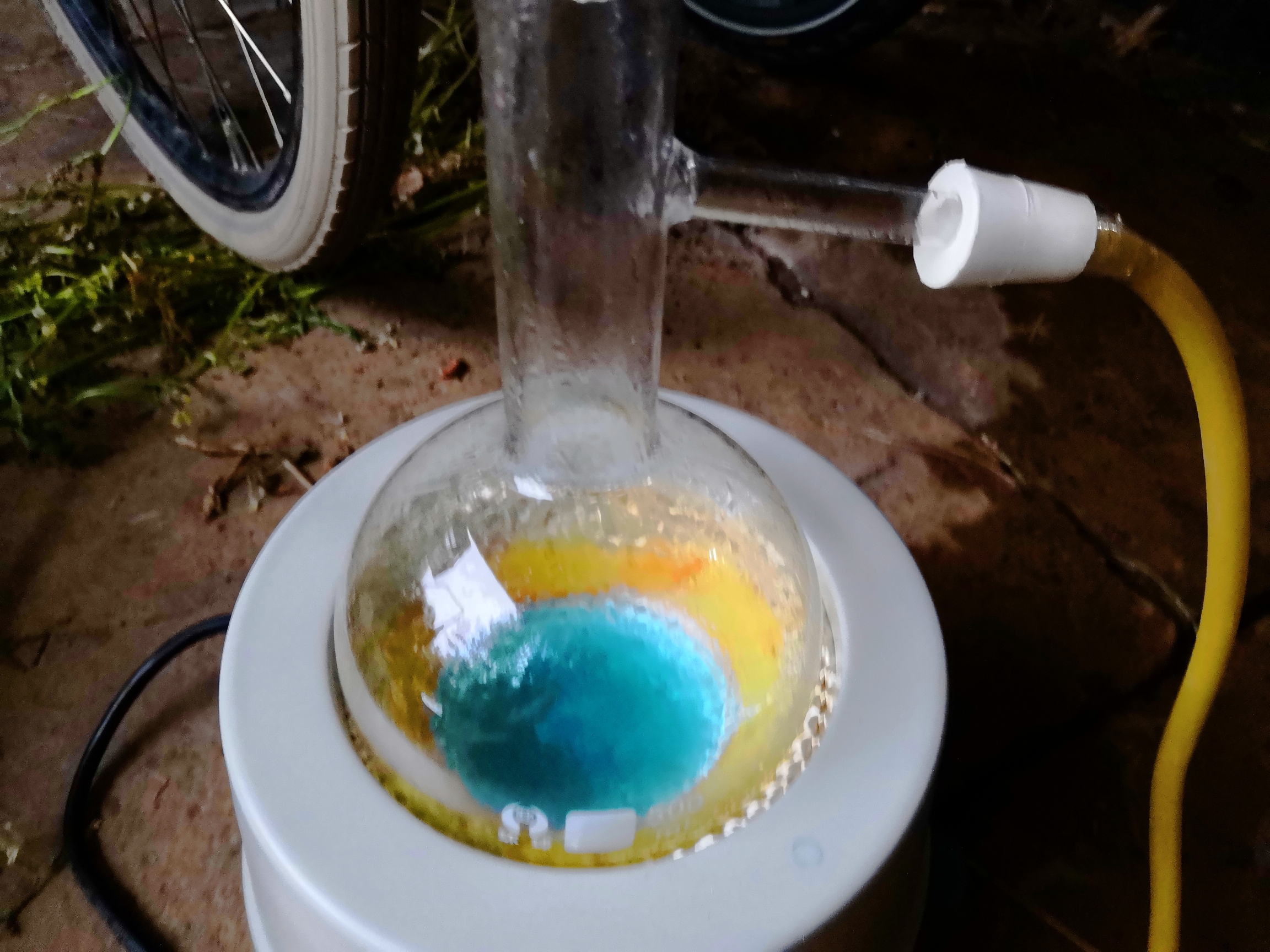

What is this yellow stuff?
Yesterday I made some copper acetate with copper, vinegar and hydrogen peroxide. Today I wanted to evaporate the vinegar off so I'd get copper acetate crystals. I had attached a rubber hose that I put in some water to get rid of the smell from the vinegar fumes. I think the yellow stuff came from something that decomposed in the hose when the temperature got high enough. Since the hottest part of the hose lost its color. But I have no clue what it is exactly. When I was cleaning the glassware, and filled it with water, the water became yellowish and pretty cloudy. Do any of you know or have a good guess what it is?
edit: the hose is made out of latex

My guess it is some copper compound. Perhaps you heated your liquid to drying and the edges overheated.

I've observed bright yellow-orange regions in solid copper(II) acetate before when it was boiled to dryness in a beaker and then heated for a little while longer. I'm really not sure what it could be, but I'm tempted to say it is some kind of copper-containing substance and not from the latex. Copper(I) oxide has a hydrated form which is that exact color, so it may be plausible that a little of your copper(II) was reduced back to copper(I) by elemental copper after most of the acid had been consumed. If you managed to collect a little bit of the yellow precipitate, you should leave it exposed to air and light and see if it turns brown and eventually black.

Heating copper (II) acetate will give rise to "organic stuff" and that can reduce copper (II) to copper (I) .

Food grade vinegar often contains a sugar impurity. Pickling vinegar is usually sugar free as is cleaning vinegar. Maybe it is a reaction between sugar, H2O2 and copper. Just a thought.
I didn't collect it, but I kept heating it until almost all of the liquid was evaporated. At that point the highest part of the yellow ring had turned a bit brown with some black parts.
So you are probably right.

Agreed with what's been said already. Probably reduced to copper (I) and if food grade vinegar was used then probably some contamination as well. For future use, I would buy some lab grade glacial acetic acid and dilute to needed levels. Just a thought. :)

you should try boiling a bit of the vinegar away and if it isnt brown at that point add some concentrated H2SO4, ive just boiled down a load of CuAc and nothing came out brown, CuAc is rather black with a slight blue tint
