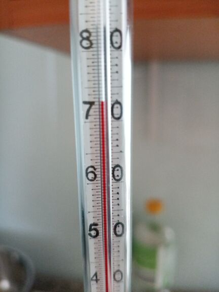

vacuum distilled, b.p. 71-73 C, vacuum level uknown (2 stage rotary oil vacuum pump), yield 79,0 g = 85% (0,5 mol = 100% = 93,1 g)

vacuum distillation
IMG_20210820_102850_9_sm.jpg - 47kB IMG_20210820_103653_3_sm.jpg - 21kB IMG_20210820_103701_9_sm.jpg - 40kB IMG_20210820_104520_6_sm.jpg - 38kB IMG_20210820_104811_0_sm.jpg - 22kB IMG_20210820_105435_4_sm.jpg - 43kB
video of the vacuum distillation:
https://youtu.be/mlR67g03YUM
