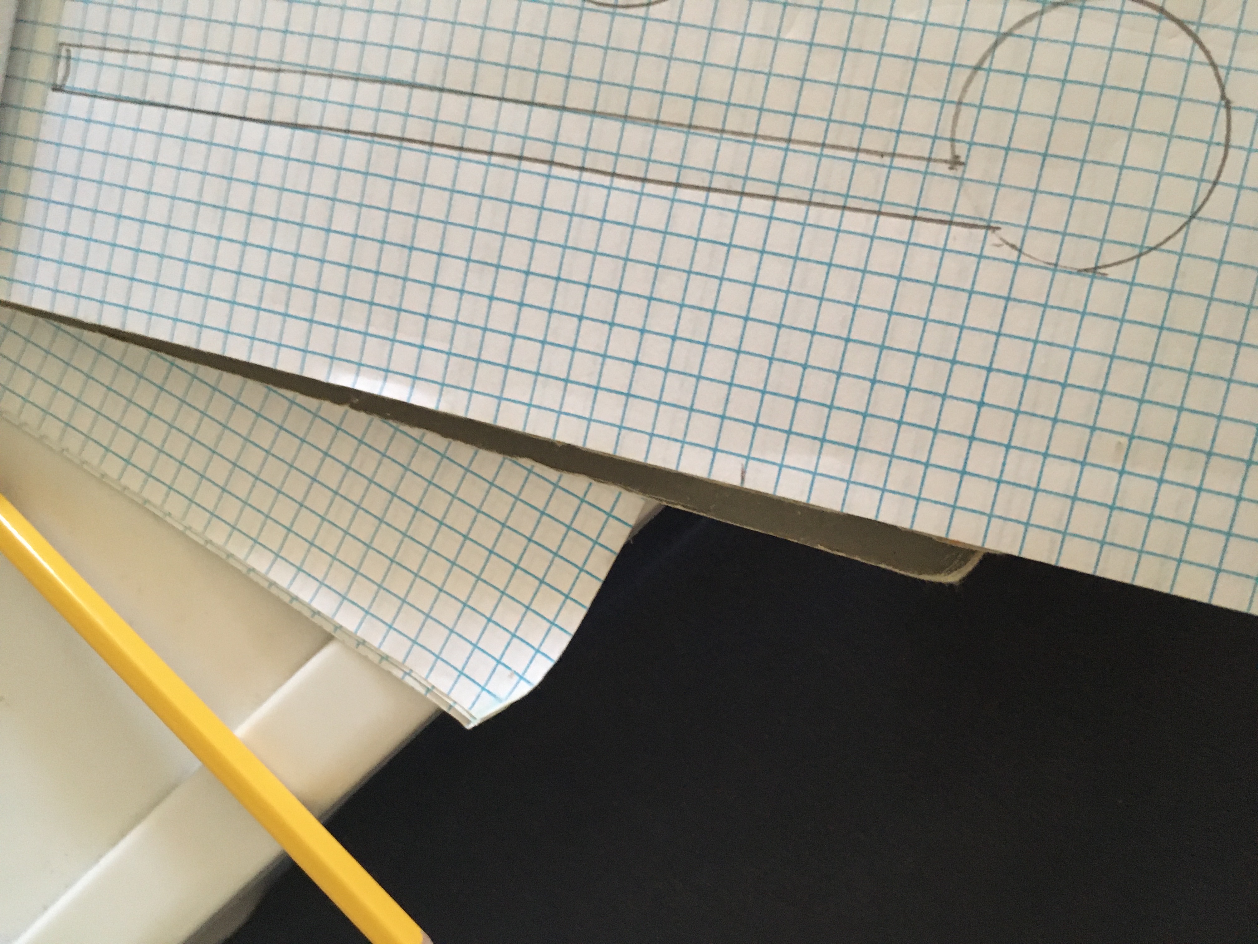

This is what I want to make, but with a lot longer of a spout.

macckone
