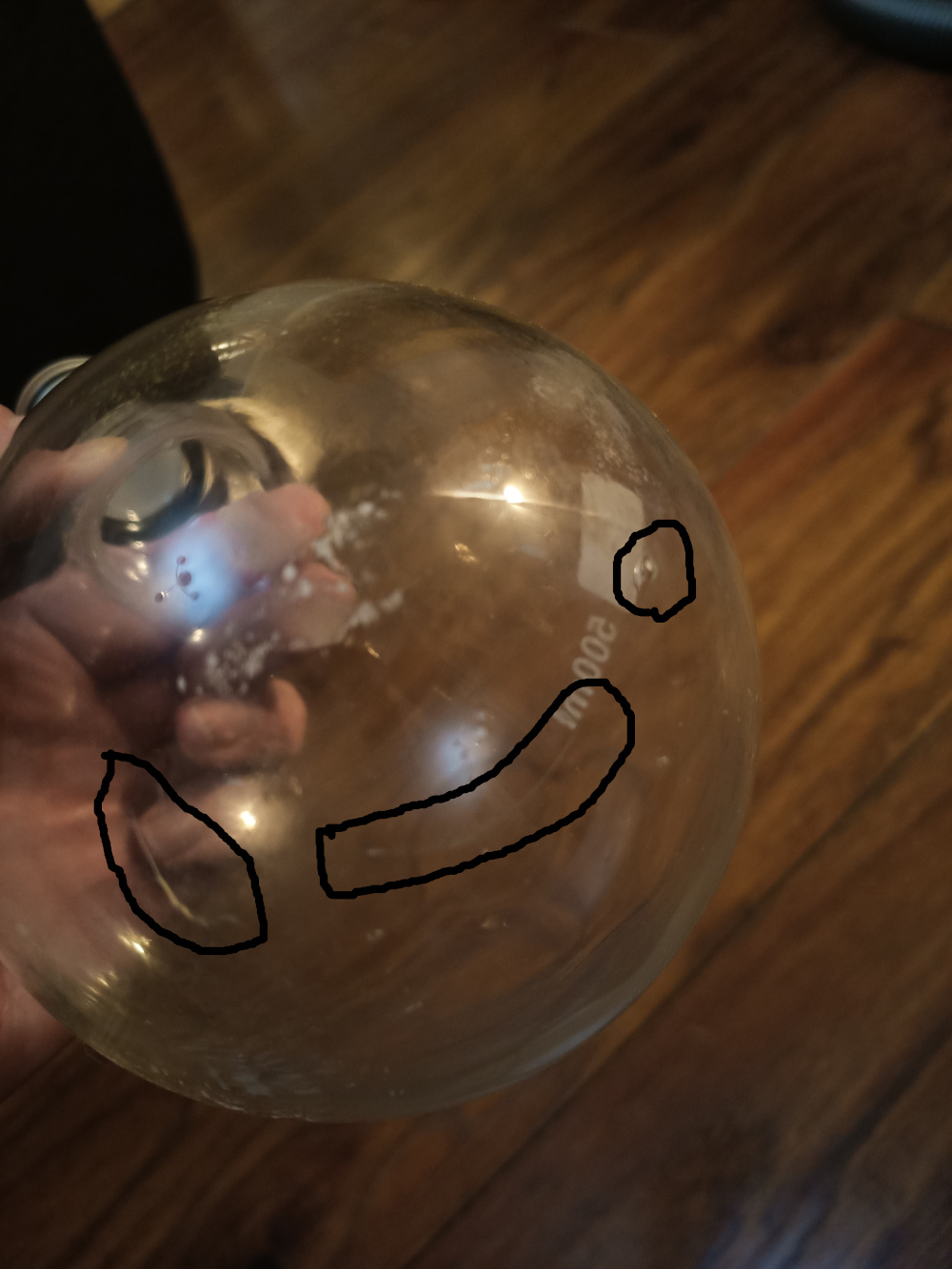

As in the photo there is a general dull area with an excavation of glass top right and then two cracks around the outside of the affected area.
IMG_20210928_230102a.jpg - 278kB

What you are experiencing is ion exchange in the glass. Strong concentrated solutions that have different ionic composition to glass will cause some surface ions to migrate.
Osmotic potential is the force behind the exchange. Sodium ions will want to move into the aqueous solution and calcium will try to move into the glass. Calcium makes the glass brittle. It becomes a glass with different coefficient of thermal expansion to the rest of the flask and so heating and cooling will cause stress at the boundaries where ion exchange has most strongly occurred.

Hey thanks, what you say makes allot of sense and I expect you are correct. I suppose the good thing is the heating is applied gradually by the mantle and failure only seems to only occur on cooling when the calcium sulfate is a solid mass and can't spill from the flask.
I am wondering if the quality of the glass might have a bearing on this issue, the flasks which I have seen fail are all from the same manufacturer (supertek) and were quite cheap. I've noticed in other reactions that better quality flasks such as Quickfit or Glassco brand seem to be more none stick on the inside surface so possibly a smoother surface finish.
I'm just not quite ready to risk a better flask to failure on this reaction yet!
