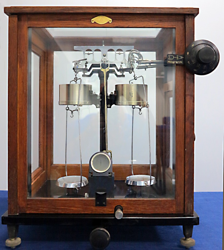

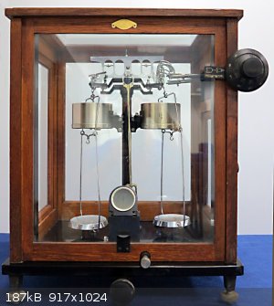

IMG_2448.corretta.jpg - 187kB
during my quantitative analytics course we tried this kind of balances (nostalgic professors)
and later we used this kind of balance with a single plate
Cattura.PNG - 1.8MB
they were pretty precise, if someone was walking behind me while i was weighting something i had to wait for them to stop otherwise the numbers wouldn't stop oscillating (they had an error of +-0.1-0.2mg).
but, and this is a big BUT, you can't use them on normal tables, we had solid concrete tables on brick "legs" but still someone walking a few feet near me would throw off the measurement. another "BUT" is that they are very VERY delicate, drop it or bump it too hard and it's easier to get a new one. The arm rests on an agate knife edge, and they are so delicate you have two weighting modes, and messing them up can damage the knife edge ruining the balance.
i won't go in detail on how these balances work, but long story short they are delicate, picky and to get a measurement it takes some time, it isn't a "put the sample, read the number" kind of deal.
oh and about the 2 plates balance, the best measurements are takes with the "tare method" (no clue how it is translated),
the length of the two arms isn't the same, even for very precise balances, so you have to first ballpark in excess the weight of you sample. on plate 1 you put anything really of that weight (coins or real weights), then you put calibrated weights on plate 2 until they match in weight. Now you can assume that the weight on plate 1 is the same you put on plate 2 (not true since if the arms are of different length the weights can be different, but doing this we eliminate the unknown difference between the arms of the balance), remove the calibrated weights on plate 2 and put the sample you need to measure and add weights until the two plates equilibrate again. to know the mass of your sample you remove from the weight on plate 1 the weights you added to plate 2 (the one with the sample).
in the end all balances can perform the same, some mechanical balances are even more precise than digital ones, but even though i like the feeling of taking measurements the old way, i want to put as much focus as i can on my project, not in weighting samples.
that lab i did was very interesting, but after weighting 5 samples per titration, and each sample had to be weighted 5 times to calculate the average, i'm really happy with my milligram digital scale xD
just a pic to show how amazing these mehanisms are

scales.jpg - 210kB
Posts: 4169
[*] posted on 1-1-2022 at 22:47
The scale have to be in grams. Imperial units are always in fractions/multiples of 2 and 3, never 10 (so eighths, twelfths, sixteenths, etc).
For calibrating weights, use coins. You can look up the standard masses of the coins of various nations online (wikipedia, or the mint's website).
Other than that, I have no advice to give.
