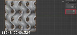

20211226_185325[1].jpg - 2.7MB
[Edited on 26-12-2021 by sarinox]
3D_Model.jpg - 115kB

[*] posted on 26-12-2021 at 08:06
As u can see in the above post, the computer says the dimensions of the cube should be 18.4 mm but the Calliper reads 17.96 mm. (I know this is because of the curvature of the edges of the 3D model as the computer measures the farthest vertices from each other so it reads 18.4 instead of 18) but let's assume in each side we have 0.44 mm contraction, therefore, we should lack a cube of Volume 0.085184 mm^3. which does not justify the 2.3 grams lack of weight in the produced piece.
I am confused! the model has thin walls as u see and I see no cavities! at least they are not visible on the surface.

Your math is wrong, you need to scale the entire part: 16.8g * 17.96^3 / 18.4^3= 15.6g
So the shrinkage can explain at least half the discrepancy.

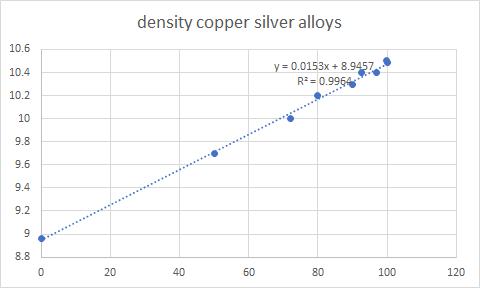

So I had a look round on the web and found this which tells me the density of some copper/ silver alloys
https://www.thesscogroup.com/products/industrial-products/si...
And I also have the density of the pure metals so I can draw a graph.
From the graph I can estimate the copper content needed to bring the density down to 9.4 or 9.3 as about 70 to 75% copper.
That's quite a lot of copper- I wondered what colour that alloy would be.
So I made some.
I melted 0.25 grams of Ag and 0.75g of Cu together.
The resulting alloy is distinctly yellow.
So, I doubt that the work you received from your metal casting works has enough copper in the silver to make the alloy with that low a density. You would see the colour.
It would, I guess, be possible to cast the metal undersize in copper then plate it with silver but that's so much work it wouldn't be worth the cost of the silver saved.
It's fair to say that I struggled to get that alloy to melt properly so, if there's anyone out there with better skills and kit who could repeat the test I'd be grateful.
