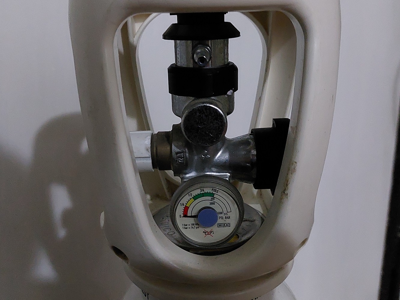

A few months ago i was going to dinner with my ex, and while walking i saw a high pressure gas cylinder right next to a recycling trash bin.
I tend to get very excited when i find stuff like that near trash bins so without thinking twice i loaded the 7L (8.45Kg) steel cylinder in my backpack (just picture a guy walking with a gas cylinder half sticking out their super saggy school backpack) and brought it to her building.
When i went home i loaded the thing the same way, but now instead of walking i was driving in the middle of the night on my electric scooter xD
Once i got home and the adrenaline faded off i took a better look at it, to behonest i thought it was a CO2 cylinder since that area is full of pubs, but nope, it is a medical oxygen cylinder.
Let's talk now about the problem i have with it, being considered a medical device these kind of cylinders need to be sent back to their suppliers at the end of their life (there was a tag with all this info on the cylinder). The previous owner apparently was too lazy to give them a call and just decided to throw it next to a bin next to the road, and now i have it, but i can't legally use it.
It is "expired" so to be able to refill it i would have to bring it to a serviccing company that tests high pressure cylinders and have its expiry date prolonged another 10 years (if everything is fine with it), BUT, and this is a big "BUT", i'm not the legal owner of this cylinder, so i can't see how i could just service this cylinder that belongs to some medical company.
My parents told me to just throw it in the bin like the last user did (lol), and my friend told me to just call the medical company to come and get it out of my hands.
Now, talking between us, it is still a nice piece of equipment, i really don't want to get rid of it if i don't have to, and for sure i don't want to call the owner company and tell them i just picked out one of their cylinders out of the trash, and fore sure i don't want to pay any disposal fees.
One idea i had was to fill it at home with something else.
I wouldn't fill it with oxygen for a few reasons:
  1. I don't want to screw with oxygen, compressed gases are dangerous enough, and if they even are a strong oxydizer, nope
  2. I can't test the integrity of this cylinder at some testing facility, max i could do is buy/borrow a hydrostatic hand pump, fill the cylinder with water, and pressurize it to 250-300BAR
  3. Right now i have no uses for an oxygen cylinder, i have a microtorch with a 1L disposable oxygen cylinder, and after 3 years i still have oxygen to spare
I could go to a welding shop, rent an argon cylinder, transfer as much of the gas as i can to my tank, and bring back the rented cylinder to the shop
This way i would "own" my own tank instead of having to pay rental fees, something i can't afford since i rarely use gas cylinders (paying 100 euros a year for a cylinder i barely use could be invested somewhere else in the lab)
If i ever manage to make a hydrogen generator i could fill it with low pressure hydrogen. yeah i know i wouldn't fill it with oxygen but i would with hydrogen? at least hydrogen is more useful to me than pure oxygen (it's more of a "no bad idea" than a "hell yeah i'm doing it")
Last resort i could cut it and make it into a crucible for a coal foundry?
I'd appreciate your ideas and feedback, i really don't want to get rid of it but i also feel bad having it and not using it (i don't have infinite space, so if i have something as bulky as an oxygen tank, i better find a way to use it)
Here are some pics
20220102_182600.jpg - 203kB 20220102_182620.jpg - 315kB 20220102_182709.jpg - 467kB

1) the bottle looks to be in good condition

I’ve dealt with welding/gas supply places pretty extensively for some years now. The two places I’ve had accounts with the guys that work there are really into what they do and encouraging of people experimenting as long as they’re safe. One even upgraded my tank size for free! But in MY experience (one of these was at a large chain, AWG) they are very helpful. If you go in there and just say “hey I got this tank can I get it swapped” the dude will probably talk to you. There’s no such thing as an illegal oxygen tank it’s just a fucking tank.
I think a GREAT reason to have oxygen as a home chemist is for use with a propane/oxygen burner for glassblowing/lampworking.
Only issue with your tank is that it’s got what I’m guessing is a medical regulator on top. For anything else you’re going to need a new top with fitting for a standard two stage oxygen regulator. A welding shop may still be able to help with this.

This is where I’m a little unsure about your cylinder! To use a standard oxygen regulator you would also need to have a whole new valve and maybe a different collar on that cylinder. The threadings in the fittings for various gases tend to be different. I think I mentioned in another thread recently.. nitrogen and co2 fittings are the same but oxygen has its own thing.
The whole idea of renting an argon tank, filling your tank halfway up, and returning the tank… well HERE it just doesn’t work like that. Places that have gas cylinders refer to it as “rental”, but you don’t pay a monthly fee or anything. You just pay for the tank, then when it’s empty you swap it out for a full one. At this point if you did this, you would already be the owner of an Argon tank - so what would be the point of filling up your oxygen tank halfway and returning the Argon tank - when you already have an argon tank?
You are probably right about the threads, i haven't the experience with big cylinders of different gases, so while i know oxygen has it's own thing, i don't know specifically which threads are different.
About the rental of the tanks, you can do both. We call it a "deposit", you buy the gas and give a deposit for the tank, when you want to refill it you just give the old tank back and they give you a new full one (you only pay now for the gas refill), so no, you don't actually own the tank in this case.
The other "contract" i saw is you literally rent your tank, for example instead of buying and owning a big 50 liters argon cylinder for 600 euros, you pay 60 euros + taxes per year.
With the rental system you also don't have to worry about 10-years checkups and recertifications, while if you own the tank, you have to pay those yourself

The tank companies usually don't fill your tanks, because filling them is a work process of it's own. What they do is make the magic swap of empty can + cash = new full can. At least all of the companies I know will inspect, fill and seal all of their bottles in a gas bottling plant for all kinds of customers, and they only ship out full, sealed cylinders.
So, I presume, any tank that goes for refill, is actually inspected in a routine manner along the way. I'm not sure what crap goes between the place that vends these bottles and the factory, but they never asked any documents, papers or anything else whatsoever - just roll in a bottle that looks something like what they sell, and they're happy to balance you out with a new, full one. They did not take the protective cap off or anything, just dunked it amongst the empty ones.
Now, about the potential uses. Those tanks have burst pressures way higher than the operating pressure, in the order of 2x operating pressure or more, so using it for low pressure applications like pressurized air reservoir will carry you a long way. You will avoid having to drain it by using air dryers, and the two of my compressors have never been drained, and the older of them is 20 years and newer one only 7 years old.
Biggest issue is finding fitting threads and adapters. The gas companies go a long way to utilize special threads and adapters to prevent anything to be cross-connected. Every gas has it's own standard threads, and every country has it's own standards. I recently faced an issue of going over THREE fricken gas regulators to find the right one, and the next issue was the gas outlet, which I just finally simply squeezed in with hose clamp.
Using it as a retort would warrant you to have a large enough heat source, and large enough stuff to 1) fit in it, 2) be able to distill out, 3) be able to remove the residue. Also it must resist corrosion, many stuff will eat steel like bread and butter.
