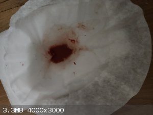

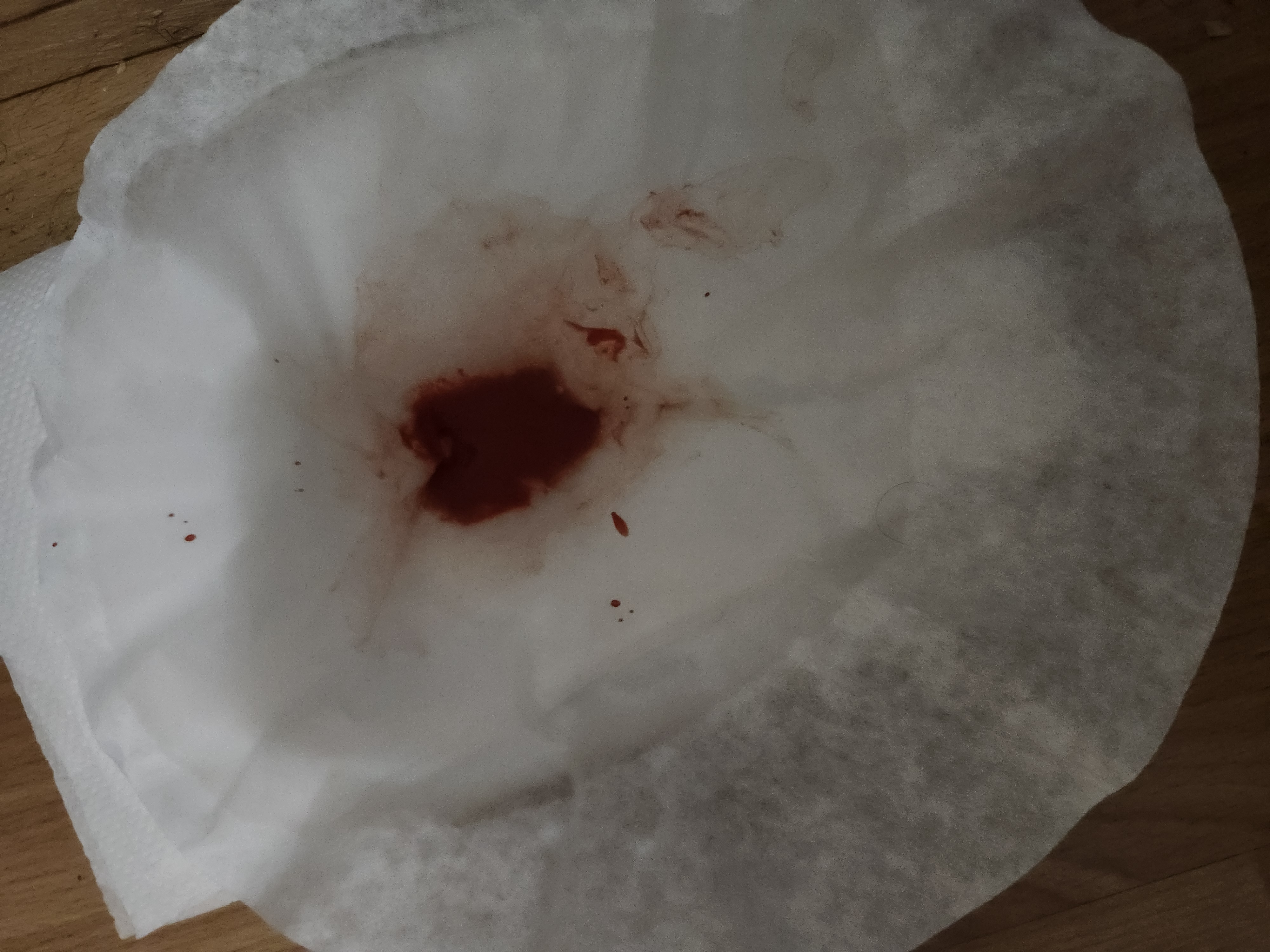

And I finally did it a second time. This time I do believe my ammonium perchlorate was pure enough to have a noticeable reaction difference. I also barely (and I mean BARELY) had any nickel carbonate left over to the point where I wasn't sure even if decanting was necessary since I only saw a singular speck of green.
I ultrasonicated it for 10.5 minutes. The temp rose from 20C to 32C during that time, but it looks like amazing. I love it! I really, REALLY hope I got a working product this time around.

It failed. I tried to light some up on aluminum foil and it didn't detonate or even burn. I used a jet lighter to generate more heat and it failed the same way my first batch did.
I honestly am at a loss as to what is going wrong. The ammonium perchlorate IS pure this time. Why it is failing is beyond me. I will need some help...

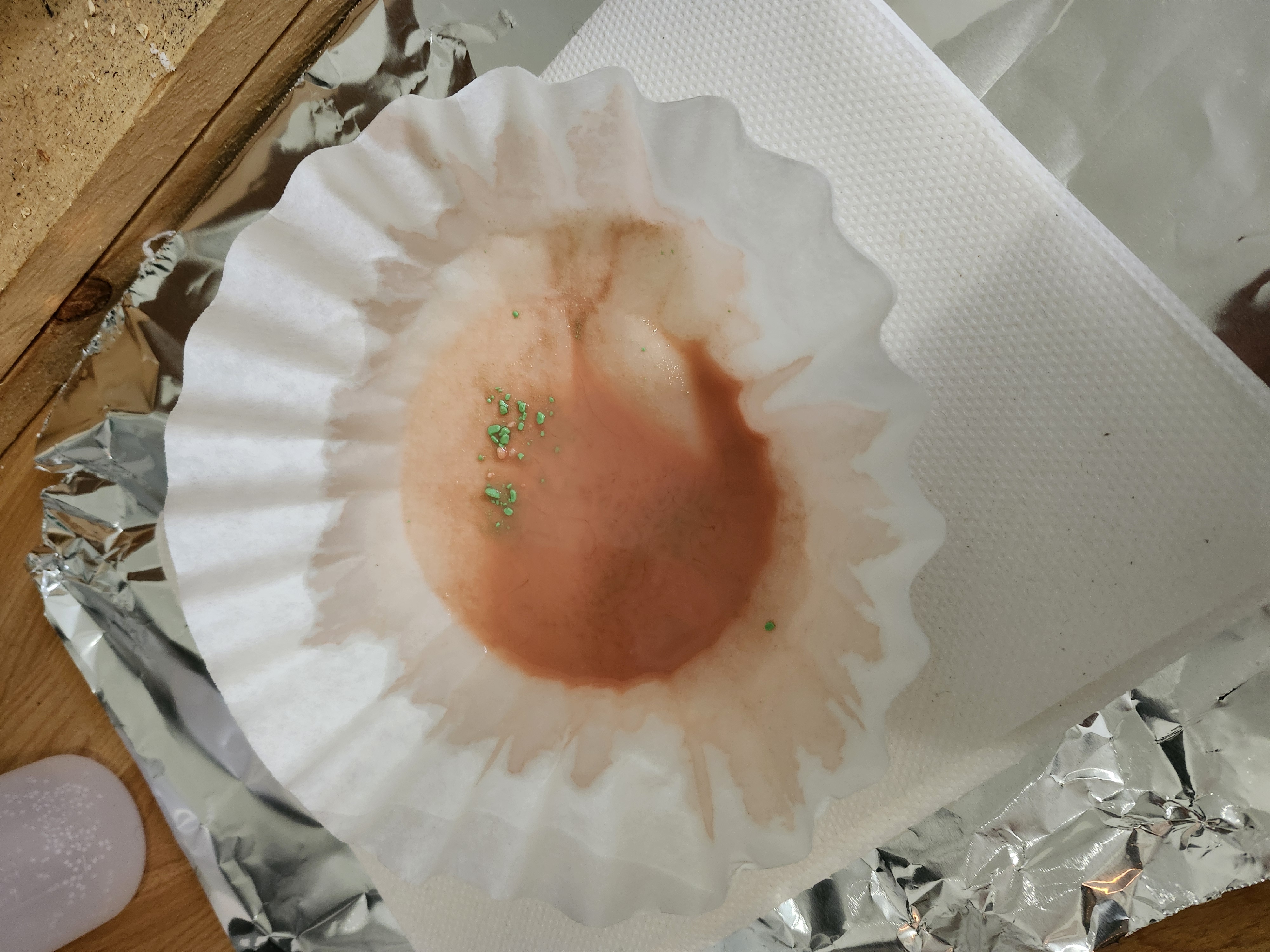

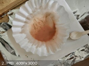

I wasted no time in trying again with iNAP. I used a the same proprotions (0.86g of ammonium perchlorate, 1g of aminoguadine bicarbonate, and 0.43g of nickel carbonate) and around 40ml of isopropyl alcohol (91%) that I brought to a boil first then added everything and I boiled with strong stirring in a mostly sealed borosilicate jar for 5 minutes and 15 seconds.
As you can see, there were some chunks of unreacted nickel carbonate that I removed (I had powdered the carbonate earlier by hand). Maybe one issue is that the mixture as I added it were mostly apart in chunks and not 100% powdered. But they all dissolved over time (the aminoguanadine was in hard chunks that I broke up with a dowel afterward in the same cup.
But there is a lot more unreacted nickel carbonate than I thought. Maybe 0.43g is far too much of an excess?

I had waited for several hours to try a little... and it does not appear to have any result.
Maybe it is not my ammonium perchlorate. I am realy, really curious as to why it is failing consisently in such abysmal ways. I am at a loss. I did everything exactly as specified but still not even a slight burn?
Edit: I am really baffled as to what is wrong.
