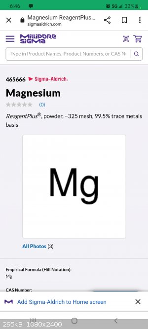

I have a supplier with 325 mesh. Can I use this for grignard if I do a slow addition and control temp or is it just simply too reactive?
CycloRook
Posts: 89
Registered: 2-4-2018
[*] posted on 19-4-2022 at 14:47
Sigma is advertising this for grignard reactions so I would assume it's ok to use.
