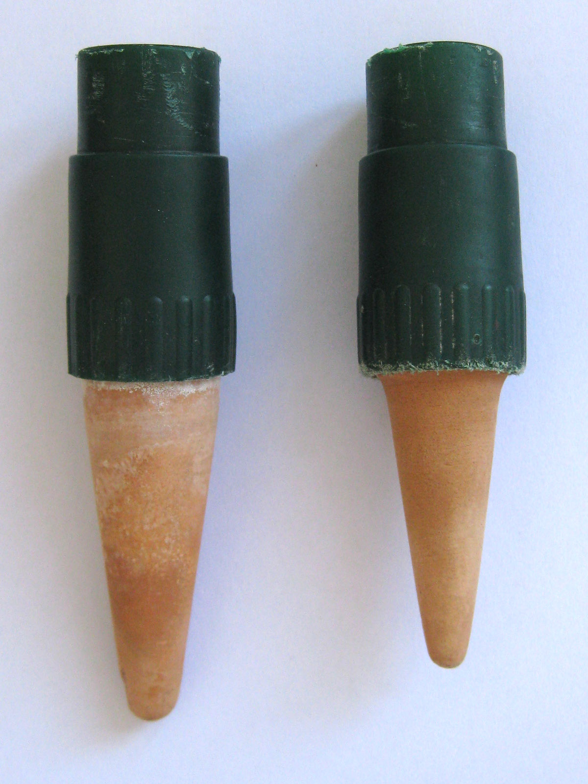

Divided Cell using "Blumat" - very simple
The construction of an electrolytic cell with membrane (diaphragm) is particularly simple with a “Blumat Easy” watering cone.
These modern Ollas consist of a hollow clay cone and a plastic adapter for PET bottles and are ideally suited as an anode cell.
Together with a container, electrodes, crocodile clips and a lid with a matching slot and hole, the cell is almost complete.
and may be put on a mag stirrer if needed. [see picture]
Unfortunately, electrical resistance of the porous but thick clay layer is quite high.
For many electrolysis processes, the required current can only be achieved using high voltage, an this will heat the cell rapidly.
However, the resistance can be reduced by making the clay layer thinner. To do this, just rub the cone over a piece of coarse sandpaper
laid out on your workbench and continue turning the Blumat in small steps.
The thinner the wall, the lower the electrical resistance. The picture shows that quite a lot of material can be removed.
In this test, the upper diameter was reduced from 22 mm to 17 mm and the sanded Blumat was about 1 cm shorter overall.
From the original 23.5 grams, 14.6 grams were left after sanding.[see picture]
An electrolysis test was done using this setup:
Nickel sheet as cathode, carbon rod as anode and 7% sulfuric acid as electrolytes. Blumat cones were soaked with electrolyte.
Current flow:
a) Without membrane 100mA at 2V, 250mA at 3V, 1200mA at 4V
b) With original Blumat: 0mA at 2V, 50mA at 3V, 110mA at 4V
c) With sanded Blumat: 30mA at 2V, 130mA at 3V, 350mA at 4V
According to simplified calculations, the original Blumat increases the electrical resistance by 33 ohms or more, depending on the voltage applied,
and by 8 to 11 ohms in the sanded version.
The clay tube used in the “Honeypot” [see older posts] which has a 3.5 times larger surface adds 2.8 ohms at 4V in a similar setup.
For a drip test, I filled the Blumat to the brim (approx. 17ml) with water. Overnight, 1 ml leaked from the original cone and 12 ml from the sanded cone.
(Clay tube: 17 of 32ml)
Dripping means electrolyte and ions may wander through the diaphragm both ways. To deal with this, here are two ideas:
- Fill the Cell to a level higher than the surrounding electrolyte and keep it higher during electrolysis by adding electrolyte as needed.
- Use a gel-electrolyte inside the cell. Xanthan (2g/liter) works well in diluted sulfuric acid with almost no increase in resistance.
