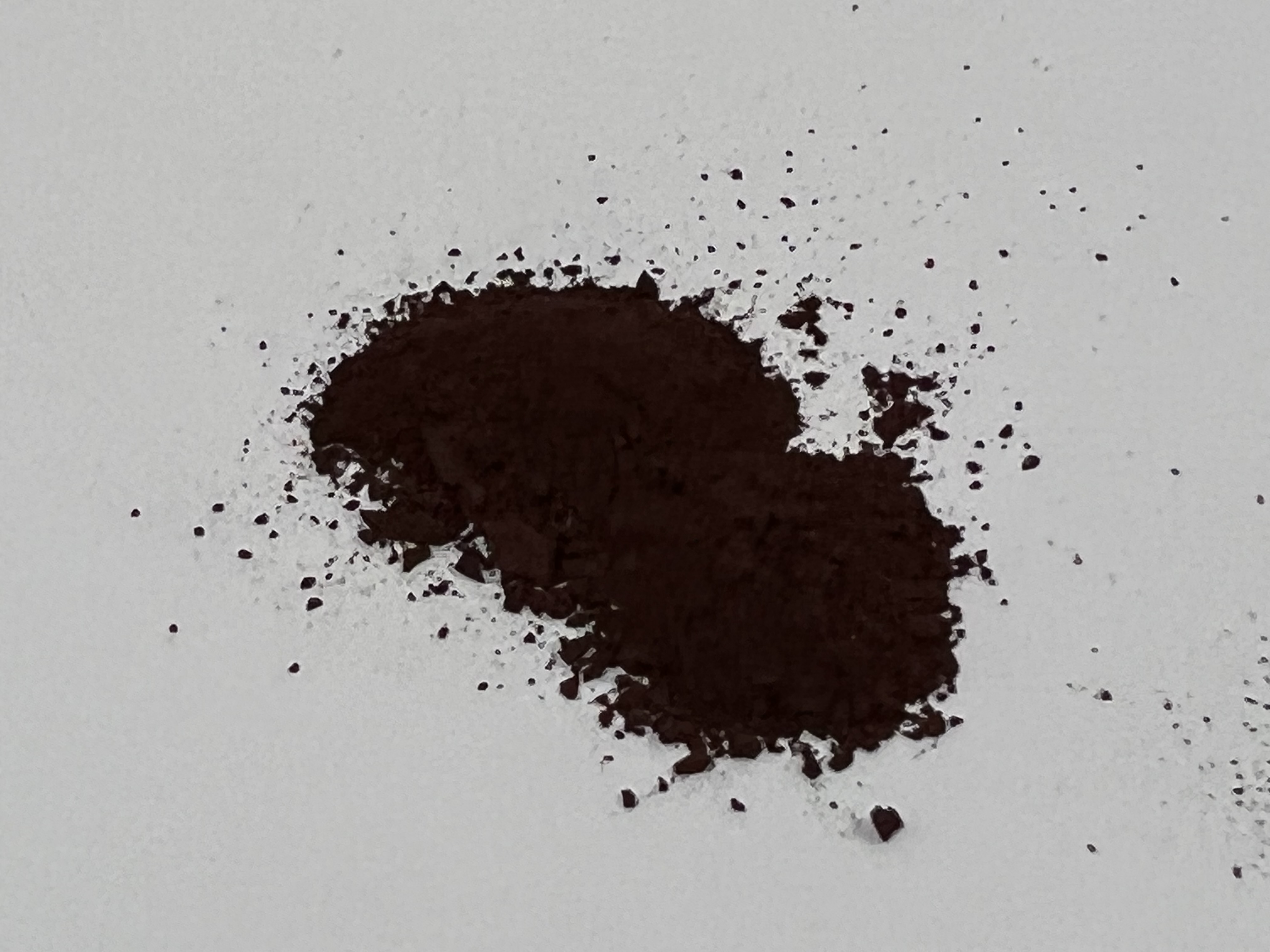

Molybdenum III - Phenanthroline complex (?)
Hello! I had some molybdenum powder, so added conc. hydrochloric acid, some of them dissolved, the solution has green color, then I added phenanthroline and it turned red like iron(III). so I made more con. solutions and precipitate this complex compound. I know Mo(III) is rare, but as I found some research, its phenanthroline complex does exist. so this very dark red compound is the result.
in live, it really has a red color, ill take a picture under sunlight tomorrow.

Mo dissolves very slowly in HCl to form Mo(V). The green complex is [MoOCl5]2- ion. So your phenantroline complex is bound to Mo(V), not Mo(III).

new photo:
302183727_752026286085249_5687268373399170299_n.jpg - 331kB

Molybdenum form usually six-coordinated octahedral complexes. Your complex probably contain Mo=O group with two phenantrolines and one H2O or Cl. But this is just guess, it could be coordinated on Mo2O4 or Mo2O3 group. If you want to know true composition, you must do some analysis.
