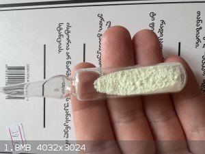

Hello! I had just 0.5-1 g praseodymium carbonate, so I made PrK3(SO4)3*H2O. it's easy to make it, just mix sulfates solutions. it has low solubility, so it precipitates instantly. not as green as other Pr compounds, but it has a weak greenish color.

unionised
Posts: 5076
[*] posted on 11-9-2022 at 10:51
Pretty.
Does it fluoresce?

Nice! I wonder how you could mix the solutions slowly enough to get crystals.....

Pretty.
Does it fluoresce?
I don't know ill try uv in this days.

May I suggest that you try the sulphamate trick to get crystals of this?
