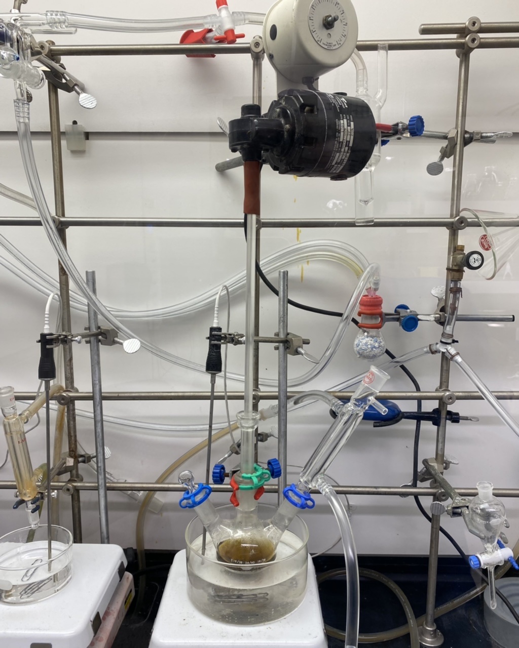

[*] posted on 25-10-2022 at 08:12
I prefer 24/40 because if you have it in a clamp, there's still room at the top for a keck clip.
I think this is an understated benefit of 24/40 that I’ve always taken for granted.
