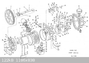

yobbo II
Posts: 690
Registered: 28-3-2016
[*] posted on 10-11-2022 at 04:38
THanks for reply.
I found another exploded diagram that shows the valve.
What is its function?
Yob
1397.gif - 122kB
Posts: 4383
Mood: PhD candidate!
[*] posted on 10-11-2022 at 12:01
Hmm, strange. I have no idea what that's for. It seems like you have quite a complicated model there. I have rebuilt a couple 1399's and a 1400, and both are much simpler than the 1397. My first thought was that if they sold the cover plate shown in the first diagram (part no. 61-8880 plus gasket 41-1508), you could just get one of those and stick it on there, not having to worry about the valve, but it appears it's not available. The gasket is available as part of the minor repair kit for the model, which is very expensive from Welch, but should be available more affordably from third party companies. Might still be worth giving Welch a call though.

I had to laugh. I emailed a company that was selling/supplying parts for Welch pumps asking what a Compensation Valve actually did and if they could supply a Compensation Valve.
I got back a reply, "Never heard of one of those'.
I re-emailed supplying a picture and diagram (like above) showning the valve and got back a reply,
"Oh that. Well, they actually found out that actually did nothing. Newer versions of the pump don’t have it. Did you want me to see if I can get you the components in there? There is also an adaptor that just blocks that off too.
