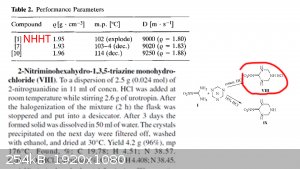

Nitroguanidine and Hexamine can be fragment-cyclized to 2-Nitriminohexahydro-1,3,5-triazine monhydrochloride (referred to in lit. as NHHT or NIHT) with hardware store muriatic acid under mild conditions and basic equipment.
NHHT is reported (without verification) to detonate at 9000m/s velocity with a density of 1.95g/cc (Yongzhong, Synthesis of Polynitrocompounds from Nitroguanidine, propellants, Explosives, Pyrotechnics 14, 150-152 [1989]).
It's futrther reported that the compound "explodes" on heating to 102 C. Other literature claims m.p. 189 C without mention of explosion.
This material came to attention during the failure to synthesize NTNT "new melt cast explosive", as a possible side reaction. Preparation of this compound was attempted by literature procedures by (me)hey buddy, repeatedly, without success. The reported high performance, simple preparation and ionic nature of this compound make it very unique in its class as a triazine, and its preparation would be beneficial to the arsenal of explosive material enthusiasts. As a compound, NHHT is regarded in the defense industry highly, and is "compared" with RDX and CL-14 as an approximate in that class. Whether this comparison is realistic or not remains unknown as this compound somewhat unfamiliar to explosive researchers, but because of its ease of preparation, should be.

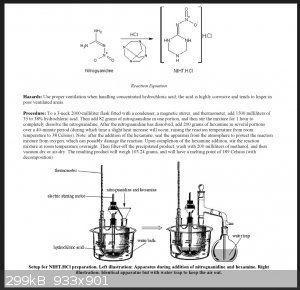

Successful Procedure
Successful rendering of NHHT was not precipitated by Metelkina's literature procedure in "2-Nitroguanidine Derivatives: X Synthesis and Nitration of 4-Nitrininotetrahydro-1,3,5-oxadiazine and 2-Nitrinino-1,3,5-triazine and their Substituted Derivatives". This procedure in my attempts failed repeatedly. At some point in time I found an old file saved on my computer titled "NIHT" which is referring to the same compound by different acronym. I have no memory of where this file came from. It is most certainly from a thread on SM from the past, but I cant find it. This procedure is in the attached picture. This procedure was successful scaled down, in many variations. The primary factor of success is closed vessel and long term reaction time.
NIHT_HCl.png - 299kB

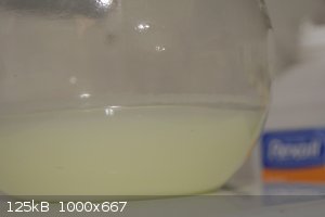

Scaled down version:
150ml HCl (sunny side, muriatic)
8.2 g Nitroguanidine (NQ)
20 g Hexamine (Hx)
No cooling is employed in this reaction and it takes place at ambient temperature with exothermic response upon addition of hexamine.
Reaction is carried out in a 1000 ml boiling flask. Teflon tape is stretched across the opening of the boiling flask which allows the flask to off-gas but refuses entrance of air which can affect yield. The teflon tape was secured by wrapping it with some electrical tape around the boiling flask neck. This tape remained in place the entire 8 Hours of reaction to prevent ingress of air.
150 ml HCl is added into reaction vessel.
8.2 g NQ is added and stirred until entirely dissolved at room temperature.
20 g Hx is added to reaction vessel in one portion, stirring continues
Reaction vessel is closed from ingress of atmospheric air
Reaction is continued with stirring and without cooling for 8 Hours
Reaction media becomes banana colored and opaque
At conclusion of 8 hours, 500 ml dH2O is added to reaction to quench it
White opaque solution is precipitated
Filter and wash with dH20
NHHT*HCl is ionic and may have application as a high energy ligand in coordinated explosive complexes such as prospective complex: e.g. [M(NHHT)x(ClO4)y] / [M(NHHT)x(NO3)y]
_MG_9226.jpg - 167kB _MG_9221.jpg - 125kB _MG_9229.jpg - 187kB _MG_9230.jpg - 183kB

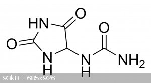

Microtek, I'm sure you're right. I'm unfamiliar with coordination chemistry. --This is off topic, but Microtek, do you think "Allantoin" could be interesting in typical perovskite coordination ie. allantoin metal perchlorate? I found some affordable as a womens cosmetic supply, so I ordered a bag of it.
allantoin.jpg - 93kB
[Edited on 10-12-2022 by Hey Buddy]
cause it looks kind of interesting to me... im curious, anyways...

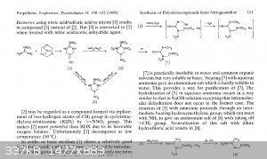

The general theme of this thread was NHHT, but in the hopes of something more powerful from nitroguanidine. Here are some related compounds from nitroguanidine. The second paper has some (bis)nitroguanidine methane heterocycles that look pretty interesting and simple.
These images are all from the second polynitro paper. They report the open molecule [7] to be 1.93g/cc but have Vd @ 1.83g/cc of 9020 m/s but with a decomp only slightly over 100 C. Not sure if the hexamine/NQ/HNO3/H2SO4 would be more powerful, but you can take that molecule and treat it with NaOH then free it from the sodium to get [7]. Thats according to the article. Or you can use ammonia and leave the NH4 as cation. Hydrazine would be interesting.
The most interesting is the bis nitroguanidine [9], and molecule [11] which is a sort of dinitrimino heterocycle. Theres also [15] which is an oxadiazine, I have no idea how that would perform but it is interesting with the oxygen in the frame of the molecule.
